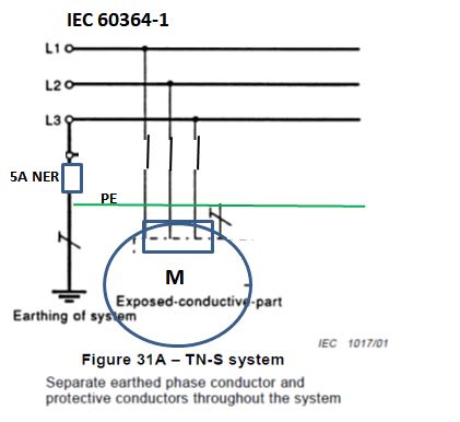

I am curious as to what the LV system in the attached drawing would be called. I am aware of TN-C and TN-C-S and TT systems. But what if the supply trfr neutral is high impedance earthed via a 5A neutral earthing resistor as shown in the diagram?

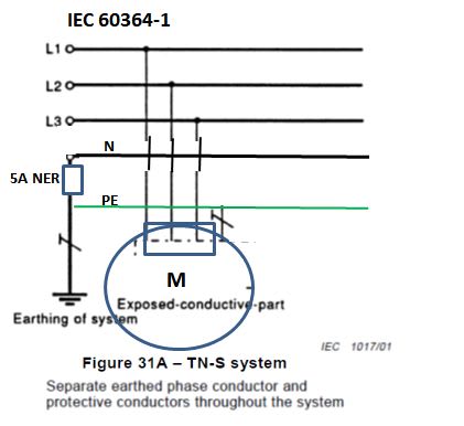

In my opinion, it is TN_S.
I know it cannot be TN as
1) the neutral is not solidly earthed and
2) there is no neutral at all

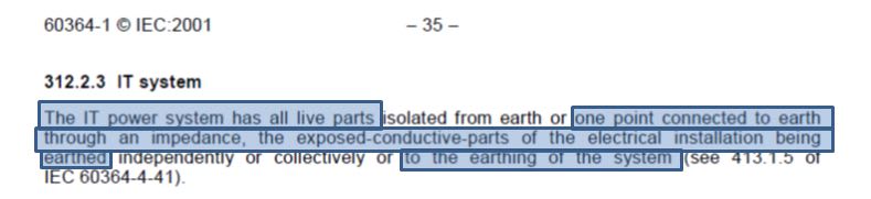

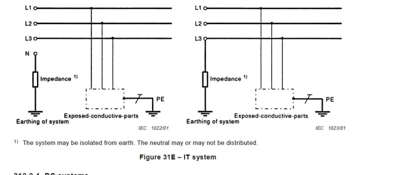

But an IT system as far as I know (could be deadwrong) means neutral is totally insulated from earth or is earthed through a high impedance like we have here. However, T means that the exposed conductive parts at the installation end are tied to ground at the installation point of intake. However, here we have a protective earth running all the way back to the source so earths within the installation are not solely connected to ground but connected to the earthing point of the NER at the source. So I'm still puzzled as to what this is. An I-S system?
How is it IT if there is PE running from the load all the way back to the source? Does the T not mean locally earthed only?
The PE is not running back to the source.
The PE is running back to the grounded end of the NER.
Not the same.
Your diagram shows the path of fault currents.
It is useful to determine the voltage rise on the surface of the motor in the event of a ground fault in the motor.
It is useful for comparison with a solidly earthed system.
With a 5 Amp NER the voltage rise on the surface of the motor will be negligible.
With a solidly grounded system the voltage rise on the surface of the motor may rise to over 1/2 of the phase to neutral voltage in the event of an internal ground fault in the motor.

Definitely not IT! I= isole (insulated in French), but you have an "earthed" line 2 of the supply lines there! My only question is why the NER is ahead of the line supplied to the loads?

In a IT system without structures being bonded together a fault could develop in one structure on phase A and a fault on another structure on phase B. Both faults would remain energized, and the 230 volt potential between buildings could start a fire.
BTW,where IT is used, typically the neutral is not distributed and all loads are connected line-line.
Yes- typically not distributed.
Tie the structures together, or add an RCD so the earthing system does not become energized one two standing ground faults.
