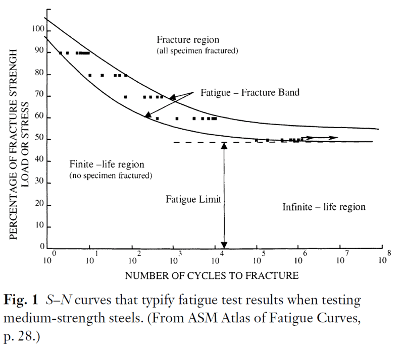

BeBtr - you need fatigue S-N curves for your material. Then given an R-ratio (min/max fatigue load) you can compare your static stresses to appropriate S-N curve to see where you fall re potential fatigue failure.
Interestingly, to GregLocck's point is a paper from 1999 "There is no infinite fatigue life in metallic materials" by C. Batthias, but infinite is in the eye of the beholder. Nevertheless, the attached illustrates SWComposites point:
TTFN (ta ta for now)
"infinite" life in steel is well known for decades (since before i was in uni)
maybe in '99 Batthias meant in Aluminium (ie in aerospace metallics, tho' yes aerospace uses steels) ?
the parallel concept of "crack growth threshold" (ie no crack growth below some value of stress intensity) is also pretty well known (these days).
