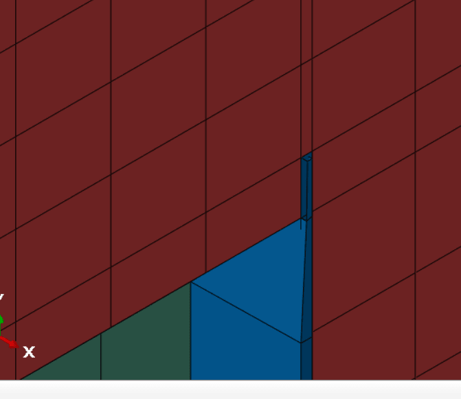

I have a shell structure and solid structure with merged nodes (Nodal equivalence) in Abaqus. The thickness of the shell structure is 1.5 mm . What should be the section thickness that I should assign in *section ?Generally we select the mid-surface for assigning the section thickness. I dont want the shell structure to penetrate into the solid structure as I have merged the nodes.
Red is the shell
White is Solid
Green is solid
How did you merge the nodes ? In Abaqus there’s no such option as nodal equivalence so I guess that you used HyperMesh for meshing.
Anyway, you can use shell offset option in Abaqus if you want to offset shell’s reference surface from midsurface. However, you should make a space in solid parts for shell with given thickness to avoid interference.

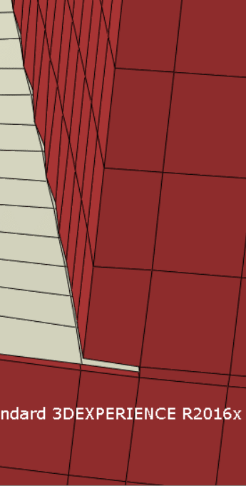

I dont want to change the geometry of the solid part. Taking the shell offset from midsurface is adding thickess on the inside as shown below.

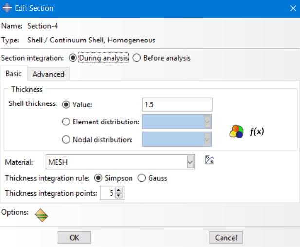

You could also use tie constraint instead of merging nodes. It would be easier this way.
The error that you get refers to variable shell thickness defined on the nodal basis. How did you set this feature ?

Using tie the nodes which are tied are like attached and rest of the element is becoming wavy. I didnt use variable shell thickness based on nodal distribution.
That’s most likely because of insufficient adjustment tolerance. In tie constraint settings switch from "Use computed default" to "Specify distance" and enter the approximate distance between the nodes that should be connected (increased a bit just in case).
Variable shell thickness is a functionality that allows you to define shells with spatially varying thickness. It can be defined in shell section editor (Shell thickness —> Element distribution or Nodal distribution). I assumed that you used this feature because the error that you had was referring to it.

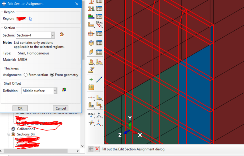

I noticed that your shell section assignment uses thickness from geometry. You should switch to "From section" if you want to specify thickness in the section editor.
Hi FEA way,
Shell section assignment using thickness From section option and mid surface is having convergence issues. I have not used variable shell thickness.
