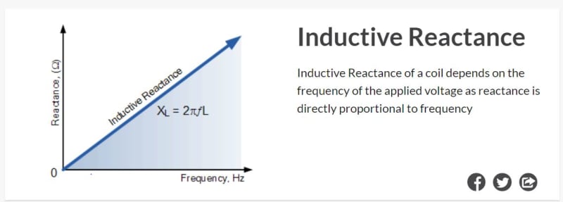

One thing you can do with the CPC100 is reduce the injection frequency and the impedance of the circuit. It goes down to 15hZ, I believe. If you can reduce the injection frequency to, say 40Hz on a 50Hz basis, your relays may still read this.
Phew! Thanks for that. Though I had made a blunder somewhere. The reduced frequency is an interesting idea but yes, I'm wondering if the relay (SEL-700G) filtering will kick in and also, how much additional current will it really allow? I.e what is the decrease in trfr %Z in going from 50 to 40Hz? Did not do the maths yet.
