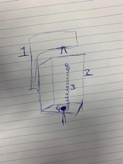

Hello,
I am doing a internship and I am working on a device that has a spring to generate force, by pressing it downstairs and hold it in that position. When a release button is pushed then the spring goes back to it's normal form and releases the power.
Now I am looking for a few system that could replace the spring, because my boss wants get rid of the spring.
Has some one a idea that could replace a spring and still generate enough force?
hopefully someone can help me!

what is pressing down on the spring to create the force at the moment?
A sketch/picture would help a lot here.

T explain it more I added a picture in my anwser.
1. Is the button that attached on the spring
2. the box/device the spring is located in
3. Is the spring
4. Stick with rounded tip in it.
So what it does is: that you need to push the button (1) down so the spring will be pushed together. Once it is down the button will attach to the stick (4) and the stick will hold the button in place, because it is held back by a "release button". So now the energy of the spring is stored until the release button is pressed. When the release button is pressed the button will shoot upwards with the attached stick.
Now we wanted to see if there is another simpel system that could do the same thing as a spring. Because we need to destroy the device it would be easier if every material is the same, so it could be destroyed and reused.
So if this clears thing up and some one has a idea that would be helpfull. Because I don't need anwser what concluded that my boss just give me things to do etc. This isn't my boss, but my school who said I should look into it and to do research.
