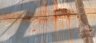

What type of corrosion is this? Pitting or General corrosion or
Carbon steel Deminilarised Insulated Water Tank. This is found after removing insulation. tank 20241208_104008.jpg
Tank is near to sea .

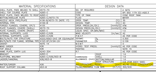

Tank is Carbon steel. ASTM A 283-C or A 573-70. Built around 2016

the tank appears to have a galvanized coating, which may be not thick enough or had incomplete coating. moisture will penetration through the plate.
causing corrosion. depending on the type of
insulation, the chemicals in the insulation may attacked the coating and the steel.
op
did the insulation have barrier on both sides.
or was it on the outside only allowing contact with the insulation.
This is all what the client provided. Only outside barrier for insulation
If it was insulated with the normal materials, then the corrosion is more likely to be classed as corrosion under insulation CUI. Next time ensure a top quality, qualified tank lining coating, or dedicated anti-CUI coating, and a top quality insulation job.

I would describe this as general corrosion with some areas consisting of multiple deep pits and some isolated pitting.
"pitting corrosion" is more normally like acne - multiple small pits of variable density and depth. once they grow into each other like it ooks here, then it becomes a larger general corrosion with some variation in depth.
why do you want to split hairs?

Protected the surface. If the top is not covered. It defeats the purpose. As noted is appears liquid was running down from the top. Evident by the first photo.
Looks like it was galvanized or coated, and the surface was damaged in some locations.
Either your weather proofing and drainage is poor or you have a lot of condensation.

You will only know about the pitting after you gently grind some of these and measure how deep it is.
If thickness is acceptable then you could remediate the tank.
This would be similar to what is done for water towers.
Clean the surface back to white metal and use a three layer coating system with a zinc-rich primer as the base layer.
Was there ever a sacrificial anode installed? And agree with EdStainless re remediation.
There is no remediation, the corrosion has to be cut out and replaced. Once corrosion starts it has be completely removed.
