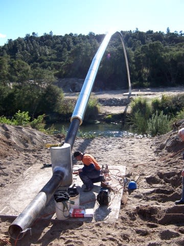

This a geothermal hot water line. The curve allows the pipe to expand. Design code B31.1. Also uses a number of pipe thickness, thinnest at the top, to pass EQ and wind loads.
The river channel has a small flood range. Channel ~18m, pipe span ~ 50m.
