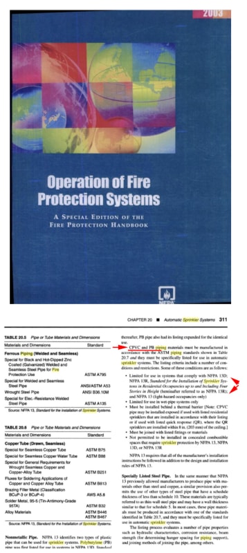

Any more pictures showing the stamps on the pipe
Couldn't help myself, had to go find out the whats and wheres.
From the 2003 NFPA Handbook:
It appears to me that PB pipe was approved for both 13D and 13R systems and even some 13 light hazard systems.
Now for the big question of the day.... if you got a break or cut pipe HOW DO YOU FIX IT?
I remember the thread
Seemed to be in the Atlanta area, and suggested a company walk away from repairs.
That almost always involves a system re-pipe as I understand it. There are no fittings that can be used with the pipe to transition to a current material.
