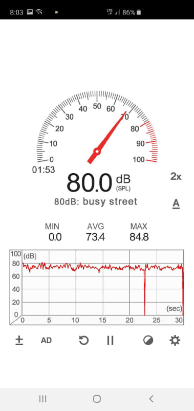

A completed hospital project. Got a complaint for higher noise level of around 52 dB in staircase , where as acceptable is 45 dB. Cool air supplied through FCU unit. After adjusting flow/vcd, clean filter and all, we didnt got much success. We further analyzed the drawings and found that the FCU flow is more than what is required in design and increased flow rate creating whirling/whistling kind of noise while passing through the grills. But could not able to prove that the noise is due to this reason. Staircase is completely enclosed and silent space. Another stairwell having correct FCU unit as per design, but there also we are facing noise issue. Can anyone advise, what else i could try to reduce the noise, please.

52 dB is measured with handheld Sound Level Meter. NC measurement were not carried out.
