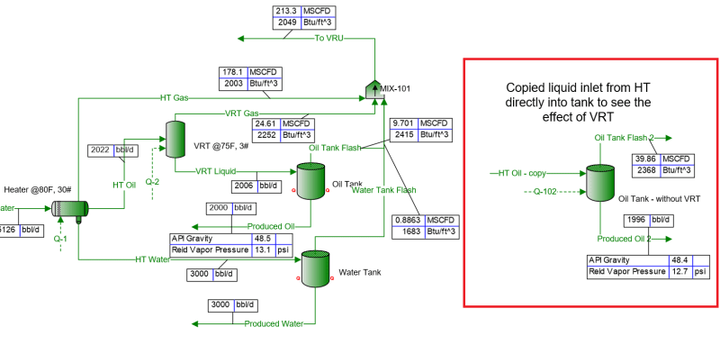

The below image is a process simulation I ran for with VRT vs. without VRT. You can see that the scenario with the VRT produces ~4 bbl more oil, but this is definitely not enough to justify the cost of installing an additional vessel.
Maybe you mean that your particular oil does not contain enough vapors to make to economical to do it. Run your sim with API 60

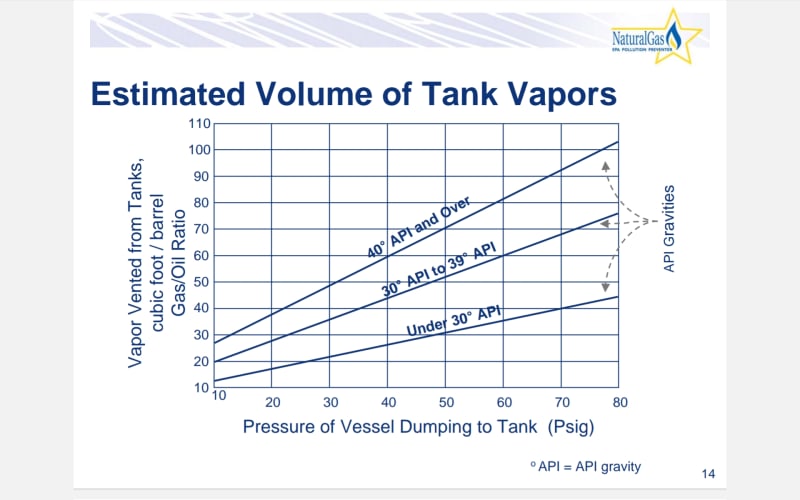

If you're just running the line into a low pressure separation tank, you must blow off all the high vapor pressure liquids in the stream. High API crudes may contain a lot. If you do not capture those vapors, you lose product, revenue value and pollute the atmosphere. Crude are getting lighter and gas emission limits are now more strict, hence more VRT are in use. The days of blowing it off to atmosphere are over. Move on.

There will be no lost vapors vented & flared from the atmospheric tanks because the VRU will be running. Doesn't matter if the crude is high API or not, because all the flash & working & breathing vapors will flow into the suction of the VRU, which operates at 4~8oz, which is below a PRV and thief hatch set points.
In fact, you lose more vapor by installing a VRT. In presence of a VRT, the VRU is usually hooked up only to the gas outlet of the VRT. While the VRT operates at 3 psig to it can capture "most" of the vapors, there are still ~3 psig to flash at the atmospheric tanks. These flash gases will have no where to go other than vented & flared, because no operators are gonna install 2 VRUs: 1 for the VRT, and 1 for the tanks. The only potential problem I see is the gas blowby problem @georgeverghese mentioned.
With VRT: VRU is hooked only to the VRT operating at 3 psig. The ~3 psig worth of gas that aren't flashed from the VRT will be flashed from the atmospheric tanks. The flash gas from the tanks will have to be vented or flared, because there's no VRU hooked up to the tanks
Without VRT: VRU is hooked up directly to the tanks, and it recovers every vapor flashing from the tanks to the suction of the VRU. No flaring & no relief valve venting because all gas will be sucked into the VRU.
Please check out the attached PDF: 1 scenario with VRT vs. without VRT. It's a process sim schematic I built recently.

Your vapor pressures are low. A high API crude is boiling at atmospheric pressure, so you can't put it in an API 650 atmospheric pressure tank.
@1503-44
In the uploaded PFD, the vapor pressure is low because I operate the heater at 150F, providing sufficient heat to flash off most gases in the liquid stream. If I turn off the heater and operate at 80F, the liquid in the tank reports 20 psia, which is above 14.7 and therefore boiling as you mentioned.
Let's say that I turned off the heater, and the liquid in the tank operate at 80F today. The reported vapor pressure in this condition is 20 psia. Two points to make here:
1) TVP is a vapor pressure of a liquid in equilibrium at 100F, according to ASTM D1267 method. For now, the tank operates at 80F, and it's stable. But it will start evolving gases if temperature goes up during a hot summer day, experiencing severe flashing & working & breathing losses. THIS STILL DOESN'T MATTER, because even if the liquid in the tank is above 14.7 psia TVP, and therefore boiling, because that boiled flash gas will still be captured by the VRU. As long as the VRU is there, no venting or flaring will occur. The suction of the VRU for atmospheric tanks is always set under 10oz, so if the VRU is properly sized to handle all vapor volumes, and its running, the pressure in the tanks will maintain below the thief hatch & PRV thresholds, and flare line back pressure.
2) Installing a VRT has barely any effect on lowering the TVP, the main driver to TVP is the temperature of the heater according to my sim results.

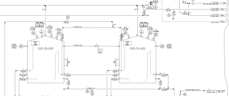

+ The attached image is a P&ID of wellsite atmospheric oil tank. The gas outlet in the middle of each tank goes to flare line. You can see that it has to PRV attached to them. But on the left and right of the middle gas line, there are multiple relief valves that vent to air.

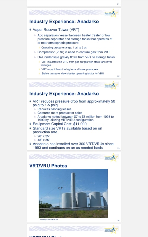

Let's just say its a preference based on industry experience factor.
2008 data
You are seeing so many now probably because the API is nearing 60.

Kind of late reply to this, but I've found a P&ID of of a pretty advanced upstream facility that has horizontal atmospheric separator rated at 100psig @200F, with operating condition @8oz. This atm separator has pneumatically operated diaphragm pumps that push liquid into the atm tanks. The discharge supply gas from the pump routes back to the atm tank inlet (so the supply gas is not vented... I've seen some operators that just vent this pneumatic liquid pump supply gas to air...). This is from an operator company that target zero-emissions, so I'm assuming that they put this additional vessel instead of a VRT to prevent appearance of the "large gas cloud" you mentioned that may appear from the tanks due to gas blowby. This makes sense now. Thank you,
I'm assuming that they used atm horizontal tank instead of VRT is because they don't like the potential overflow issues with VRTs in case of slug flow. I've seen VRTs frequently experiencing liquid carry over to the compressors.
