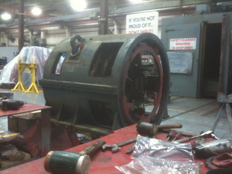

JASGripen asked a question I feel I'm able to answer accurately.
There is a rather popular size "hammer" used in motor repair shops.
It is the Number 5 Garland rawhide mallet. It (and other sizes) are a favorite used by professional electric motor mechanics.
John
Finding some more photographic examples.
Here's a shot showing the classic Garland mallet(s) resting on a bench-top used in electric motor repair.
