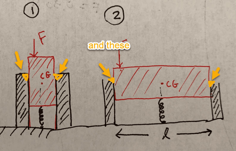

Let's say i'm designing a rectangular button with these two different cross sections. The button is constrained on the left and right by a vertical wall and supported on the bottom by a spring directly below the CG. The only difference between options 1 and 2 is length l.
Three questions:
1. If a force is applied off center, why is option 2 more prone to "jamming"?
2. Why can be done geometrically to reduce likelihood of jamming?
3. What if the button was a cylinder instead of a rectangle, would that help and if so, why?
[URL unfurl="true"]https://res.cloudinary.com/engineering-com/image/upload/v1652147076/tips/IMG_2919_brvepq.heic[/url]
The wider button has a greater moment around the spring for a given F. The button is rocking in the bore. To fix this you need think like a bearing. Clearance and supported length are important. Less clearance prevents rocking, more supported length increases the resistance to rocking. See the width/height ratio in your drawings. If you can't make the button itself taller, consider adding a shaft below the bottom guided by a second bearing.
Thank you TubboatEng, your comments are aligned with my thinking. Can you clarify how the bearings would be incorporated to help fix this?
And I'm also struggling with the free body diagram that explains why a more supported length increases the resistance to rocking/jamming. Can you help explain it through a free body diagram?
The shorter the support the greater the allowable angular movement so the greater ability to have an off center load produce a moment, which is reacted by a couple in the support, increasing the contact force and the contact friction. You can demonstrate this with almost any drawer that doesn't use a ball bearing. Slip fit wood drawers are really good at jamming.

What you have is the classic desk draw situation, have you ever pulled a draw out on its slides (not rollers) and it sticks? Then you have to pull slightly on the side Of the draw to pull it square before you can open it further.
Basically the draw wedges a because when it tips and contacts the side of the slides you need an increased force to overcome friction.
Have a look at this site it explains friction locking with wedges and basically your piston in option 2 is tipping and acting like a wedge.

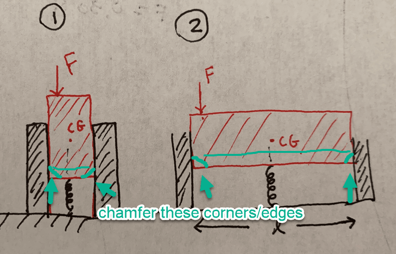

CORNERS!
Chamfer the corners that are in contact with the side wall.
Make sure the edge corners (when looking down from top of button) have plenty of relief. Rounds on hole corners should have larger radius than button edge corners.
(This in addition to advice about side walls)

Can you explain why the chamfers would help. I saw on a following thread you said it "keeps two sides of a corner from contacting at once" - Why does this help.
From a top view of the button, I'm imagining you recommend filleting the edges and chamfering the corners as shown attached?
 https://files.engineering.com/getfile.aspx?folder=11c9e850-83ac-442e-8545-be4903aa1e32&file=Button_bottom_view.PNG
Thank you for the images TheTick. I understand that adding the chamfers would help with positioning and inserting the button into the hole/slot. But once the button is inserted, in terms of jamming - won't the added chamfer effectively just affect the geometry as if the button was shorter (to the top edge of the bottom chamfers) and the side walls shorter (to the bottom edge of the top chamfer) since those will be the new edges that will make contact first?
I don't understand why added chamfers would help with jamming.
What i've learned from everyone (thank you everyone!) is that increasing the side wall length of the button aids in reducing angular movement and increases the lever arm such to reduce the reactive force on the wall (thus reducing friction). Wouldn't adding the chamfer reduce the side wall length thus worsen it?

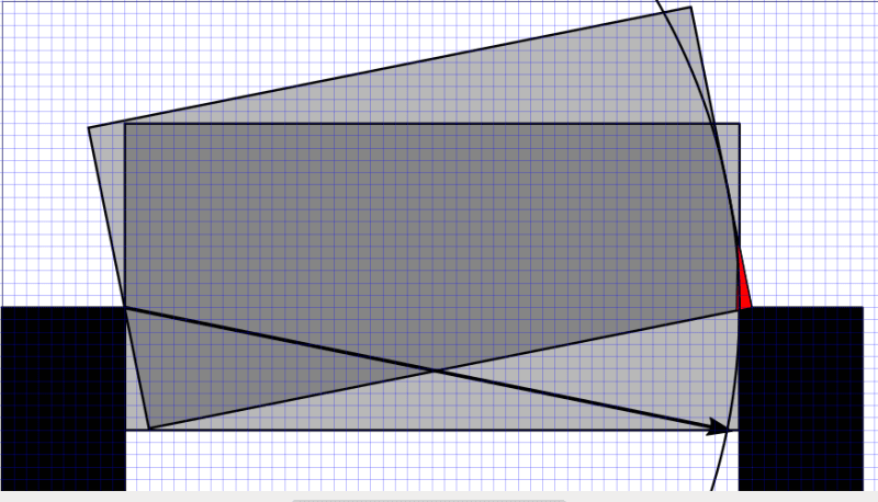

At the least the chamfer removes a sharp corner that can gouge in. It also helps make the item behave a little bit like a shape of constant width - if there was a radius from the centered at the top edge/outside of the button shell to the opposite corner of the button, then the button would not increase in width and touch both sides at the same time, so it could not jam. The easiest insertion depth to do this is at the start when there isn't much interaction to guide the item straight, so a small chamfer can approximate that.
That little red sliver off the corner allows the button to rotate into position without jamming.

You won't have a sharp 90° corner digging in to the sides with the chamfer. It doesn't take much. Just enough to deliberately blunt the edge. 0.25mm will do.
Also more mold-friendly than a fillet. If your button is molded, the part line will likely be on that edge, which may have flash as a result.
