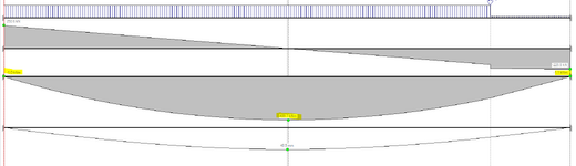

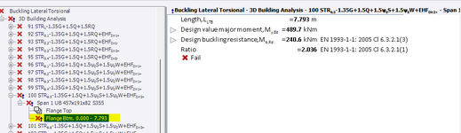

Why is the maximum sagging moment being used in the LTB checks when I have restrained the top flange?
BA123
Mar 11, 2025
I'm posing this question, as it seems that Tekla Structural Designer is using the maximum moment when checking the LTB of the bottom flange, for a fixed ended beam, this max moment in the section can be a sagging moment (i.e. bottom flange in tension), if it has the greater magnitude.
I would have thought the logical moment to use for checking LTB of the bottom flange is the hogging moment, where the bottom flange is in compression. There is a tekla support article (which can be found by googling my thread title), that references "Annex G for BS 5950 and Section 6.3.2.4 of EN 1993", but I'd like to know why the max moment is used regardless of which flange is in tension/compression and not just "this is the code".
Can anyone explain the reasoning behind this?
Thank you

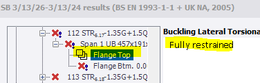

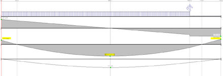

Thanks all, just for clarification I have a beam with fully restrained top flange, unrestrained bottom flange.
The beam is fixed ended, and so goes into hogging.
I am using Tekla Structural Designer, and there is an article here which gives some more explanation https://support.tekla.com/article/w...-in-the-ltb-checks-when-i-have-restrained-the
I was hoping there was some further logic as to why the maximum moment is used to check for LTB of the bottom flange, when the maximum moment could occur where the bottom flange is in tension.
You can see this in the screenshots.
I can't wrap my head around why the hogging moment isn't used for the LTB of the bottom flange (i.e. when it's in max compression).
If for example the maximum hogging moment was 0.0001kNm (e.g. a tiny bit of fixity at beam ends) then the beam bottom flange would still fail in LTB using this approach, which is clearly a nonsense.
