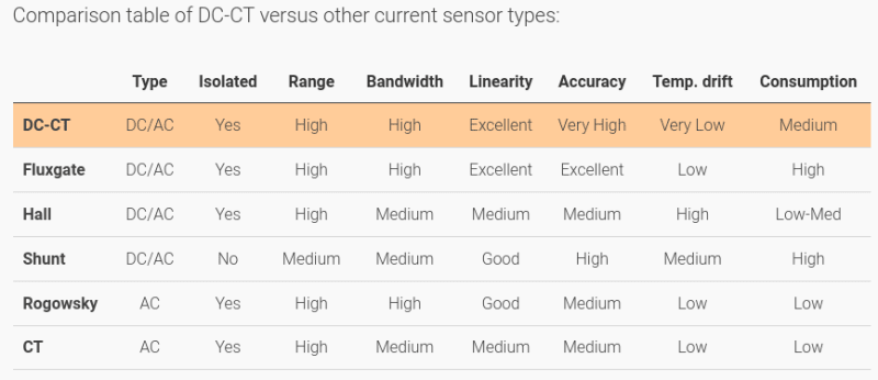

A current transformer is only sensitive to the changing (di/dt) portion of the current, so no it will not get damaged by high DC currents. A current transformer can get saturated from a large DC current which could result in inaccurate measurement of the AC component.
If you need to measure the DC current, this is a list of sensor types to investigate.
Source I have no experience with this particular source.
(edit) There is some literature discussing demagnetizing transformer cores ( it is likely that if residual magnetism in a CT core creates signal distortion, it should be possible to demagnetize a CT with a similar tool.
