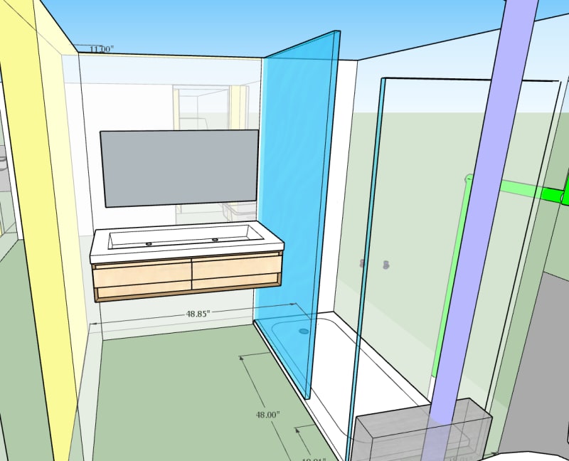

Will this wet/dry vent solution work ?
MiniMe4Eng
Jun 19, 2015
126
This is a sequel of a previous thread I posted here, I was trying to relocate two pipes that are in a wall that separates my toilet and my sink
Below is a middle ground solution suggested by someone, I am trying to relocate the vertical grey vent in the below picture
I am not clear on how the things connect under the slab at the bottom of the stack (will have to open the floor)
What I wanted to run through you is the way the green segment work as an alternative to the grey segment
The bath tub will rotate 90 degrees counter clock wise and will be replaced by a shower pan
The sink will move to the south of the picture in the corner where the bath tub ends and its piping will be used to build the green vent
it will look like this
