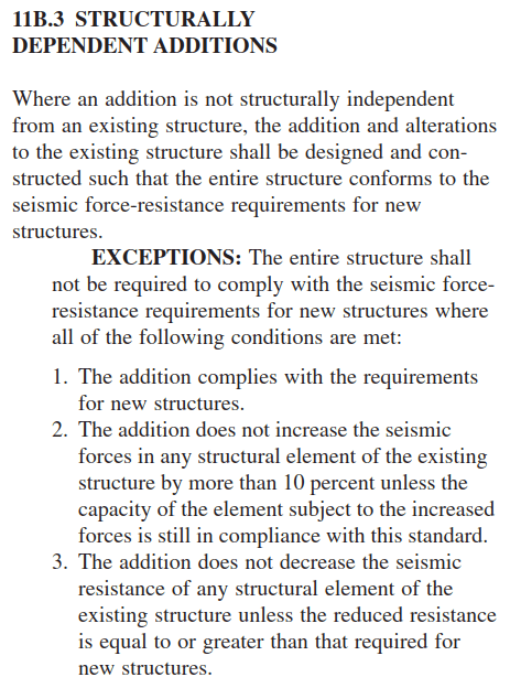

This is my go-to for things like this, ASCE 7-10:
Agreed with MSL, that would be an absurd ask for this type of project.
Sounds like you are putting in a new unit, not replacing an old unit, so if your jurisdiction has adopted some form of the International Existing Building Code (IEBC), your project would be a Level 2 Alteration, see 2018 IEBC 806.2 and 806.3 for the gravity and lateral load requirements. Check your actual local jurisdiction to determine what code may apply and what amendments they may have adopted.
I would expect to do a quick gravity load check to distribute the unit's load (and any addt'l snow drift load if any side of the unit >15ft, probably not based on the MAU weight and depending on where you are in northern CA) to the primary gravity resisting system. I would calc wind/seismic loads for design of the anchorage of the unit to the roof but say the building frame itself is ok by inspection per the 10% rule if the IEBC applies(see 806.3 above) or by engineering judgement. The additional wind or seismic load on the building itself due to a new rooftop unit is like a gnat on an elephant for any remotely normal situation.
Thank you MSL and SB for your answers. I think utilizing 11B.2.2 as an exception to avoid conducting seismic analysis on the existing roof is a sound approach to present to the local B.D.. Additionally, I concur that calculating the dead load of the MAU to existing roof rafters to ensure their adequacy is imperative.
Thank you both very much. Your help is greatly appreciated.

This isn't an addition, though, it's an alteration.
