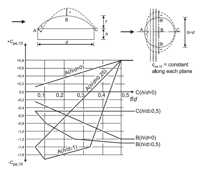

Do we need to take into consideration wind load when design roof structure for tank?

This snap from EC 1-4, Figure 7.12 - Recommended values of external pressure coefficients cpe,10 for domes with circular
base.
For your case, d=7.0 m , h= 11.5 m and f =3.5*TAN 6= 0.37 m. and h/d=1.64 , f/d=0.05
Cpe values for zone A = -1.4 , B=-0.5 and C =- 0.5
The roof having 6 degr slope, which is essentially flat. And... the full roof is subject to suction.
If you average the values proportional with the related areas, Cp value will be around -0.8
We= 0.8* 3.70 = 2.96 kN/m2 (suction pressure for the full roof area )
and API 650 proposes We= 1.44 kPa *(V/190)**2 = 3.12 kN /m2
