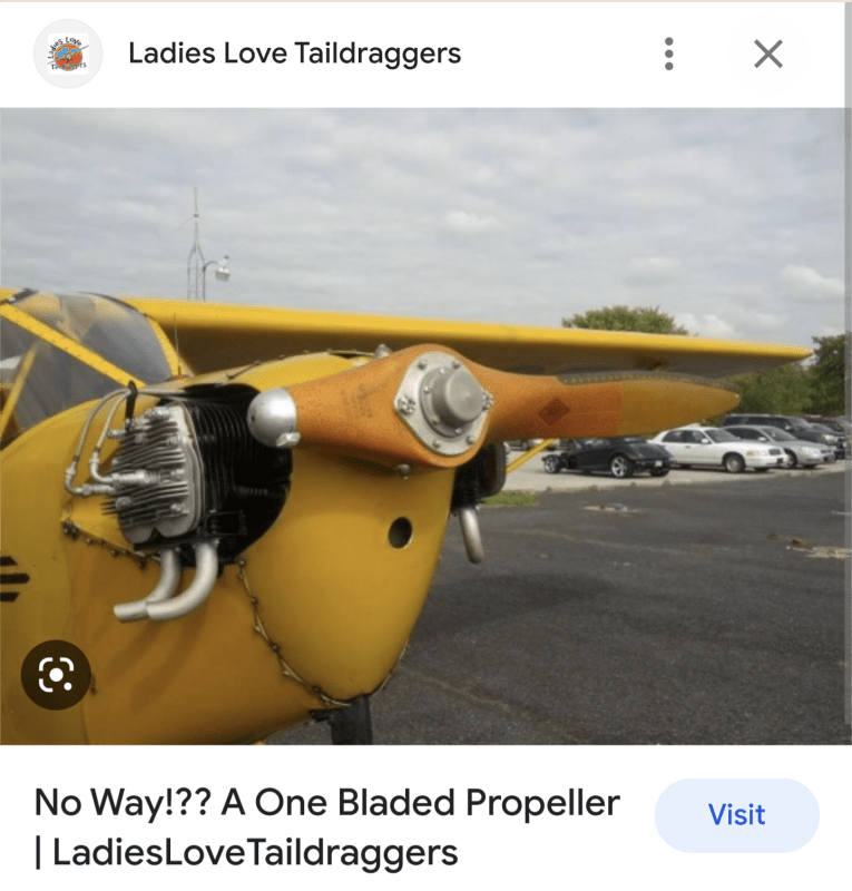

One blade is ideal. Two blades are difficult to balance. 3 blades are best. 4 blades are difficult to balance. 5 blades have too much drag.
Because Piper Cub pilots are the strangest breed:
