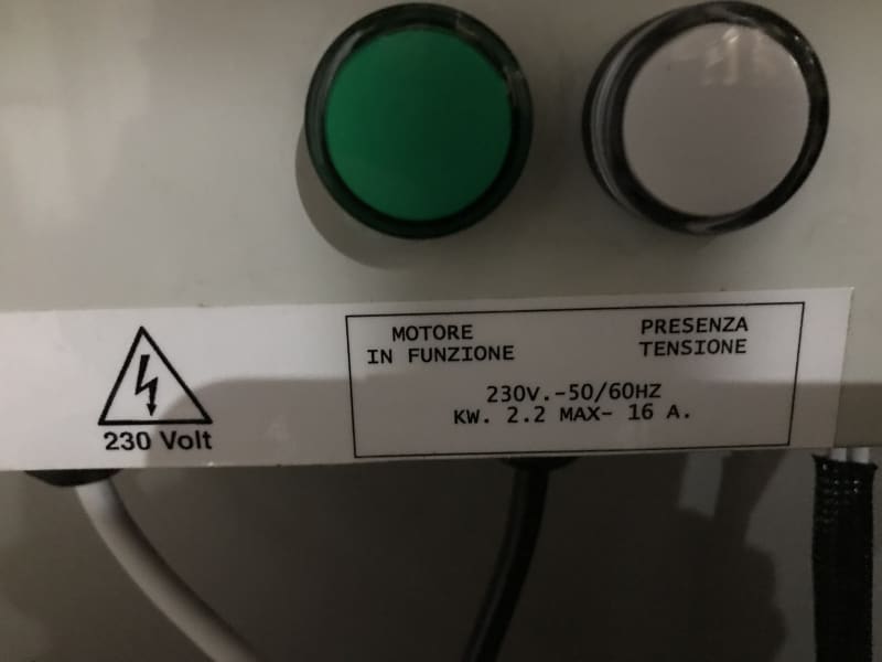

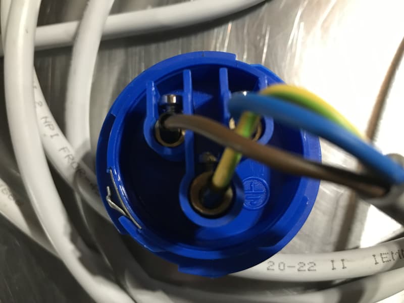

I have an Italian Zamboelli bottle filler with a control panel and motor that indicates 230V 16A 60 MHz; what is the American voltage 120 or 240V
The 60 MHz part is definitely wrong. Should be 60 Hz.
If it says 230 V 60 Hz, then 240 V is just right. Within the +/-5% tolerance that European motorized devices can run at.
If no motor - or with a VFD - then the tolerance is +/-10%, which makes it even better suited for a 240 V 60 Hz grid.
So, just plug it in and start bottling!

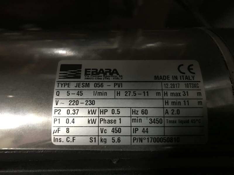

I uploaded photos
What is your opinion
OK, it says 220-230 V. The capacitor withstands 450 V. And frequency is stated at 60 Hz.
Consumption is 2 A and max fuse should be 16 A. But fuse is only for the wiring (not to protect the machine as such) so I see no problems if you have a 25 A circuit or other.
If you still feel some uncertainty, it is a simple matter to add the secondary of a small transformer, say 50 VA, in series with the live and get down to 220-230 V. Make sure that the secondary is in anti-phase, else you will get around 250 V, which may be a little too much.
But I would, as said before, not worry and start bottling after I had plugged it in.
Wiring: Yellow/green goes to Protective Ground, Blue goes to Neutral and Brown goes to Live. Talk to your sparky if the plug delivered doesn't fit your sockets.

Nick; I don't see anything on your pictures that leads me to believe it's a 120V machine. The motor does not even offer 120V as a connection change.

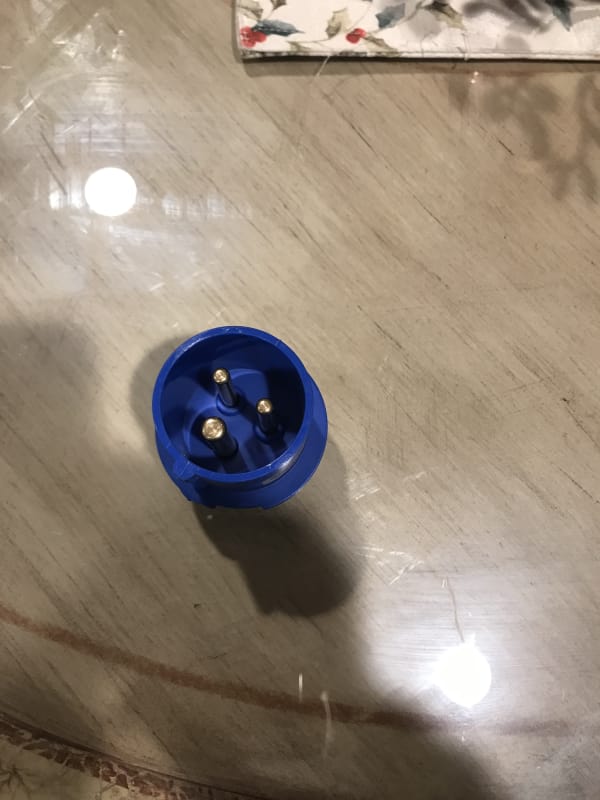

It is quite apparent from the nameplate that this is a single-phase device. Now, look at the plug that is meant to be plugged into a wall socket.
If everything has been built according to code, then it will not be possible to plug the device into a wrong voltage. North American electrical plugs found in household appliances are standardised (but quite different from european plugs) and look like this:
As you can see, due to the differing pin orientations, it is neither possible to plug a 120V appliance into a 240V socket nor the other way 'round.
Normal household electrical outlets in North American residential construction are 120V single phase, with 240V single phase outlets provided at selected locations for high-powered appliances, generally in the kitchen for an electric stove and in a laundry room for a clothes dryer.
Commercial buildings will use the same voltages and plugs for the single-phase loads as household circuits use, so if the building and the equipment have been built according to code, it will still not be possible to plug it into the wrong voltage ... unless, of course, one does something stupid such as plug it in through a "plug adapter" that doesn't take care of the voltage.
I understand, it came with a crazy italian plug
it calls for 16 amp. max and I was thinking of using a 15 amp double pole breaker as it is 240V
20 amp breaker I think will be too much
This is one of the simplest tasks ever. Still, it is going completely out of your hands.
The "crazy" Italian plug is THE standard European plug for one phase/230 V/16A. Used from Sicily to North Cape.
The bottler consumes just 2 A. So you don't have to worry about that part.
Let a competent electrician do the job. We cannot advice you if you do not understand what we are saying.
