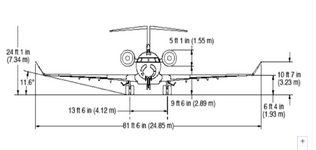

Like the 737 it's short gear makes it more prone to excessive roll.
The higher gear types you can have over 15degs roll before any chance of a tip strike. I can't find any public data on the crj limit but suspect it's under 10 Deg.
I was wondering what roll angle was "normal". The CRJ has a pretty low wing due to the engines at the back and about 11 degrees. Not so different from the 737 due to is low gear and low slung engines
I had a look but couldn't find anything.
I know for the A220 it's 16 degs but there is a EGPWs mode 7 warning at 10 degs. To be honest 10 degs of bank below 300ft is alarming while landing even for the ex military guys.
Never been near 10degs in the SIM in the flare nevermind the real aircraft.
Max xwind would be less than 5. But to be honest I don't really look at the instruments at that point. If it looks safe out the window I am happy. If it's not I do something about it. Which is extremely rare. In fact on the A220 I haven't yet. Which is more about the quality of the training department than aircraft type.
