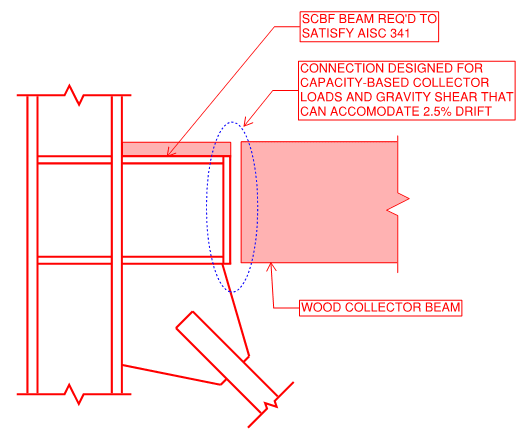

I could be persuaded to use a wood beam IF it was detailed similar to what's shown below AND you could prove that the connection could accommodate 2.5% drift as required by AISC 341 F2.6b(a). A few thougts:
1. If the intent of the moderately and highly ductile compactness requirements is to mitigate local buckling for members that will experience incidental (as a result of imposed story drifts) or intentional (fuse elements) inelasticity, then it follows that those requirements wouldn't apply to a beam that has been decoupled from the frame such that it will not experience moment as the buildings drifts. If the wood beam connection could accommodate 2.5% drift, you could argue that the beam will never see any seismic moment and compactness requirements wouldn't apply. It would essentially be acting as a collector.
2. Given the potential lack of ductility in the wood beam connection, at a minimum you'll want to design for an axial force consistent with the yield mechanism of your braces. More on that here: Link. You may find that difficult to achieve with wood connectors given the inherent overstrength in a SCBF system that's sized based on the compression capacity of the braces. If that's the case, consider switching to BRBF.
3. You may find that it's easier to clad a steel beam with wood to achieve your desired aesthetic.
