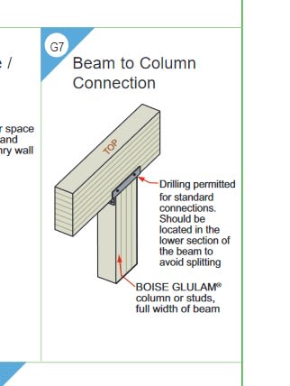

I've posted a couple of pics below that I found that sort of show what I'm thinking about. The first one is from Boise Cascade in their "Common Details" document. I'm probably thinking about this totally wrong but let's say you have a 20' wide deck where you have posts in the corners and then a midspan post at 10'.
1) Is it preferred to have a 20' long beam instead of two 10' long beams?
2) If, for one reason or another, you needed to go with two 10' long beams, would it be better to "pin" the connection rather than restraining rotation with the strap?
Most projects that I work on where this connection would come into play are on decks or long ridge beams with an interior support. I usually assume that a single, continuous beam is going to be used but in the case of splicing the beam at the support I'm wondering if I should always put a strap on there, even if I'm not anticipating any major chord forces into the beams (like on a deck where I try to move the shear into the back wall of the home).
The splitting that they show there is really the result of a tie connection not designed for the forces that it might see as a result of unintended beam continuity.
Where handling and availability are not limitations, I do prefer continuous spans. Less deflection and more continuity.
OP said:
2)If, for one reason or another, you needed to go with two 10' long beams, would it be better to "pin" the connection rather than restraining rotation with the strap?
Definitely, in my opinion.
Wood is kind of weird relative to other materials when it comes to providing rotational restraint at the supports. Quite often, there simply is not a mechanical connection that convincingly supplies that rotational restraint. I probably shouldn't say this out loud but I suspect that it works for wood because the proportions of the typical cross sections tend to give wood a degree of self stabilization rotationally. And there's nothing really analogous to the sidesway buckling that you might see with a steel wide flange beam. At extreme aspect ratios, I've no doubt that the self stabilization effect falls short.

OP - for the splitting, the concern is when the too much of section is trapped between a fastener group and bearing, or between two fastener groups that are in fixed relative positions. In this case, the post cap fasteners and the strap are separated, and can move vertically relative to one another. That allows the wood to shrink without building up stress at the fasteners and splitting.
