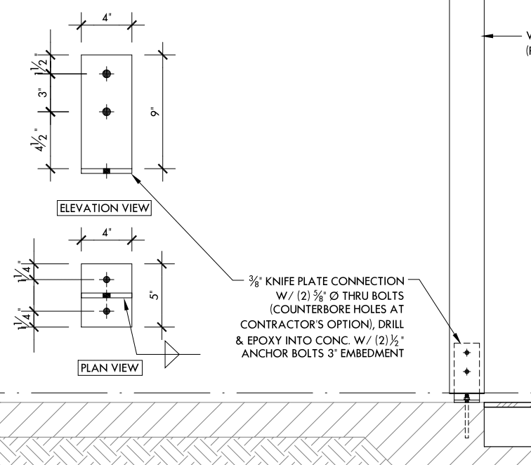

The section you cite only has to do with whether a wood column has to be decay resistance or treated, not how it is connected. If you meet any of those criteria, you can use the oak column I presume. Which criteria do you meet? Showing your detail would also help study your situation.

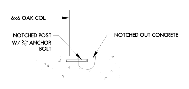

Here's a sketch of what is in place:
This is what we designed:

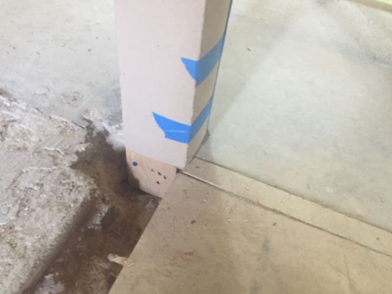

Here's a picture of the column in place directly on concrete and secured with nails (the contractor claims there is a 5/8" bolt installed now):

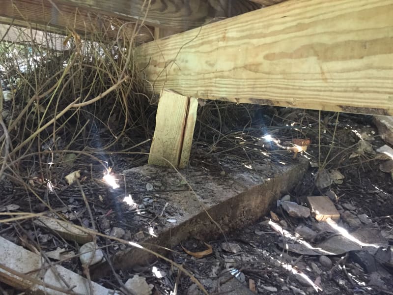

At the same project, here's a picture of a deck beam bearing on a single untreated 2x4 which is also split in half:

There are honest mistakes, and there is incompetence. You appear to be dealing with gross incompetence. I would not entertain any arguments from this contractor. I see no reason why he cannot install the connection you designed and specified using post-installed concrete anchors. The deck beam is just icing on the cake of cluelessness.

If you want another bullet point to add to the overkill of reasons the installed connection is unacceptable, the end bearing area looks to be only about half of the column cross section area, which presumably reduces the axial capacity by about half.
So he whittled out a notch in the bottom of the column and ran a single tapcon through the wood to the side of the slab? Now the untreated column is just sitting in a hole in a slab? First, fix the hole, then install the knifeplate. After that he can go wreak havoc on his next project if he wants.

His crappy detail does not meet R317.1.4 It says must be on a concrete "pier" or metal plate 1" above the floor. He is not above the floor. Also, the code does not specify the actual connection to the floor, that is your job. The exposed earth portions is not applicable at all.
