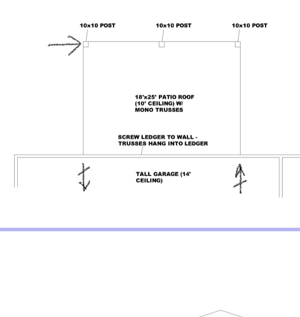

I don’t know the exact details but i guess it normally works like this (assuming diaphragm action from canopy roof). You would need to make sure you can follow the load path right through however.
I agree with MIStructE_IRE. I would be trying the diaphragm route first.
I run into this all the time with screened porches. Most engineers around my neck of the woods don't give it a second thought. We have shown moment frames on many occasions due to really bad aspect ratios or sketchy attachment conditions at the house.
MIStructE, do those crossed arrows denote reactions?

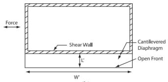

I had an epic battle with a plan reviewer in the SF bay area about analyzing a 12'x12' porch as a cantilevered diaphragm like MIStructE_IRE is showing. He absolutely insisted that it was not possible for a flexible diaphragm to transmit torsional moment to be resolved into a T/C couple at the walls. So I told him it was a rigid diaphragm, and not to forget that it's a porch. Phone call #3...He insisted that I prove that it can be classified as rigid, with the whole average diaph deflection/average story drift >= 2 (i think that's it?). I said "well, it's a 12'x12' square of 3/4" plywood - sounds pretty rigid to me." He didn't like that. I threw my hands up and put in Strongwalls. What a ridiculous porch....smh.

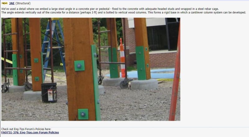

Here is one that "JAE" did several years ago. I copied the image because I thought it might come in handy one day.
He embedded steel angles in a footing or drilled shaft. Then, he through bolted the columns to the angles.
It looks like he alternated the orientation of the angles on different columns so that he could develop a moment capacity in both the X & Y directions.

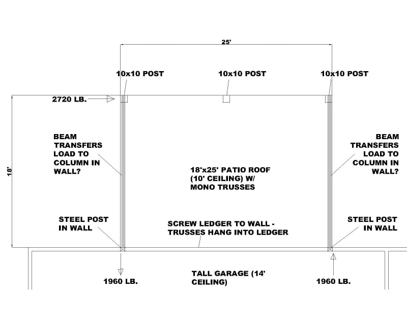

If I try the diaphragm route suggested by MIStructE_IRE then I guess my R value is 2.5 since I'd be tying it back into cantilever steel columns in the garage wall? I calculate the dead weight of this roof to be 6750 lb. (18' x 25' x 15 psf = 6750 lb.). With R=2.5 my seismic force is 2720 lb. which makes the reaction at each post in the garage wall = 1960 lb. as a force couple. Is this load transferred into the columns via beams as shown below? I don't think it will be possible to get a steel column in that wall capable of resisting that 1960 lb. and resulting moment at the base, which I think phamENG was alluding to.

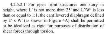

You should have cited AWC SDPWS 4.2.5.1:
@Sokka10 - double check where your seismic force is applied, half would be at the front columns and the other half at the building - correct? This may reduce your forces into the column at the building. For the building column, I would recommend a pin-pin scenario with a point load from the lateral where the low canopy roof connects to the column. Then the column needs a tie or some sort connecting it to the roof diaphragm, thereby dragging the load into the building roof diaphragm as two point loads. This way you are avoiding a moment connection all together.

Yes, you are right and that would decrease the forces in the left-to-right direction. However, when the seismic load is applied perpendicular to where I currently show it, the forces into each wall column will be the same as I am showing them currently. A big consideration here is the R value though. If I say that I'm transferring the load into the roof diaphragm and then back into wood sheathed walls then I could use an R value of 6.5?

So if I try to drag the load into beams that hang into steel posts in the wall, I also need to make sure that the end trusses are attached to the beams properly. Load path is patio roof diaphragm > beams > steel posts in wall > foundation at the bottom and garage roof diaphragm at the top > wood framed shear walls. All assuming that the patio roof diaphragm is rigid to get a force couple in the beams. Quite the load path. Then 10x10 wood posts at the exterior with standard post bases?
IBC 2304.11 Heavy Timber Construction
You've got the load path correct as I see it. Note that you're likely delivering that load to the bottom chord of the roof trusses, so you'll likely need blocking and diagonal bracing to transfer it up into the roof sheathing. Unless there's a direct path on the bottom chord you could exploit to get to a shear wall.
