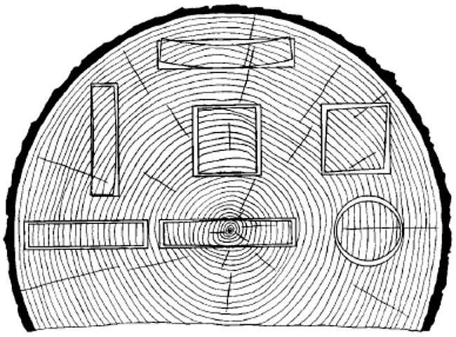

Part of the shrinkage consideration is dependent upon where within the log the 2x_ was cut from. See the image below, gives a relatively idea of the expected shrinkage depending on grain orientation. Wood tends to shrink twice as much in the tangential direction when compared to shrinkage in the radial direction.
