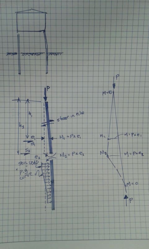

An out of plumb pile will have a bending moment. With no horizontally applied load, the bending moment at any point in the pile will equal to the vertical load P (in the diagram) x eccentricity at that point, e. e is the distance "out of plumb". M = P * e
Shear in the pile, S, at any point will be P * e / h, where h is the height of the pile from point of interest to the point of load application, ie. the top of the pile. Shear = P * e/h
The moment will be zero at the top of the pile and increase until roughly at ground level.
M1 = P * e1,
M2 = P * e2 etc.
The moment diagram of the pile is shown to the right.
Once the pile is penetrating the ground, the soil will be loaded oppositely to the shear and start picking up the shear load in the pile as it resists the rotation of the pile. Soil pressure is in accordance with the lateral resistance of the pile-soil action. That is termed the "p-y" curve for the pile. As the soil resists the shear load more and more with deeper penetration, the shear in the pile becomes less and less, as does the moment, until at some depth, the pile has only vertical load remaining which is carried t the bottom of the pile and into the soil below.
If there is a horizontally applied load "H", such as wind on the building, the shear in the pile will be increased by that load and the moment at any point in the pile will be increased by that same load x the height h1, h2, to the top of the pile, etc. M1 = M from above + H * h1, h2. etc.
If your out of plumb pile is too flexible it may sideway towards the building, in which case some lateral load may be transferred to the other pile, but only if the building's floor was strong enough to effect the transfer. In your case it seems the floor warped instead.
