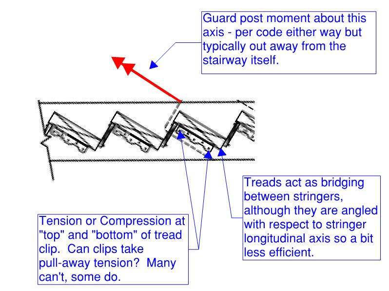

Hello everyone.
I am designing a wood stair stringer. The member size is 3 1/2"x14" Glulam (exterior use). The treads (3x12 SYP) are attached to the stringers with Simpson TA9 angles. See attached PDF for a couple of details we are using.
The railing newel posts are at 4'-0" o.c. (1 1/2" pipe) and is attached to the top of the stringer. In the event of a lateral live load of 50plf at the top of the newel post (per ASCE 7), torsion will be applied to the stringer.
First of, does anyone typically look at torsion in a stringer design (be it wood or steel)?
Second, how do I go about looking at it from an analysis point of view? The treads will provide some support, but not sure how to quantify it. The stringer in the far side is against a 2x- wall, but not attached to the wall, so it will help somewhat but not sure how much.
Thank you for your thoughts in advance.

This is one of those times when I would not try to design by the numbers.
There is a lot going on. All of the treads and risers are attached to the stringers, so when a person pushes on the guardrail, the load is distributed to more than one tread/riser. The torsion is ultimately resolved as a couple between the two stringers.

I'd be more concerned about the cross grain bending where the post attaches than the overall torsion in the member.
Any way to turn the torsion into a couple going into the treads (kinda like a little diaphragm) that is then resisted by another couple where the treads attach to each stringer where the final couple works in the strong direction?
This is clear in my head but I prolly need to make a sketch...
How do you plan on attaching the post to the top of the glulam? The tension component of the force couple will be quite large.
I agree with JAE. Need to check if the clips connecting the treads can take the pull away tension. It helps that there are multiple treads/clips in action per guardrail post.

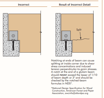

On a slightly different topic, I'm not sure I'm excited about your connection to the landing. I'm pretty sure this is right out of the "Timber Connections to Avoid" article I read the other day:
