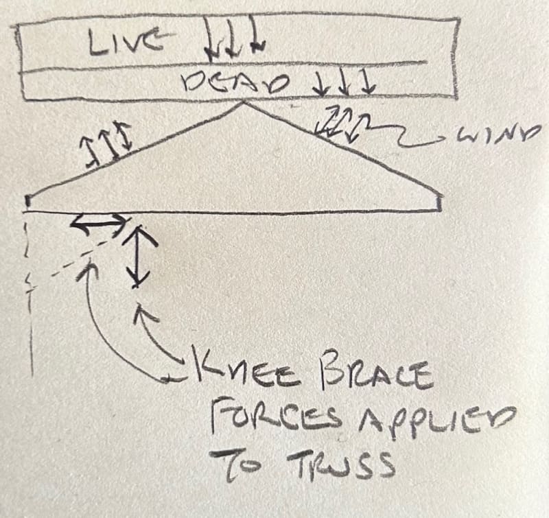

I think if you provide the truss manufacturer with a side elevation of the basic truss with the "frame" imposed loads on it you would stand a good chance of having the truss designed properly.
I'd want to call a couple of local truss manufacturers to discuss and share the load concept with them.
Something like this perhaps (very rough - there'd be another knee on the other side of course):

As others have said, you'd have to provide the forces, locations, and direction. It's definitely doable.
Although I'm wondering what that would do to the truss with gravity loads. As the truss deflected under live loads some of the force would be transferred through the knee braces.
If you wanted the truss designed for a lot of different wind cases the design could get pretty cumbersome.

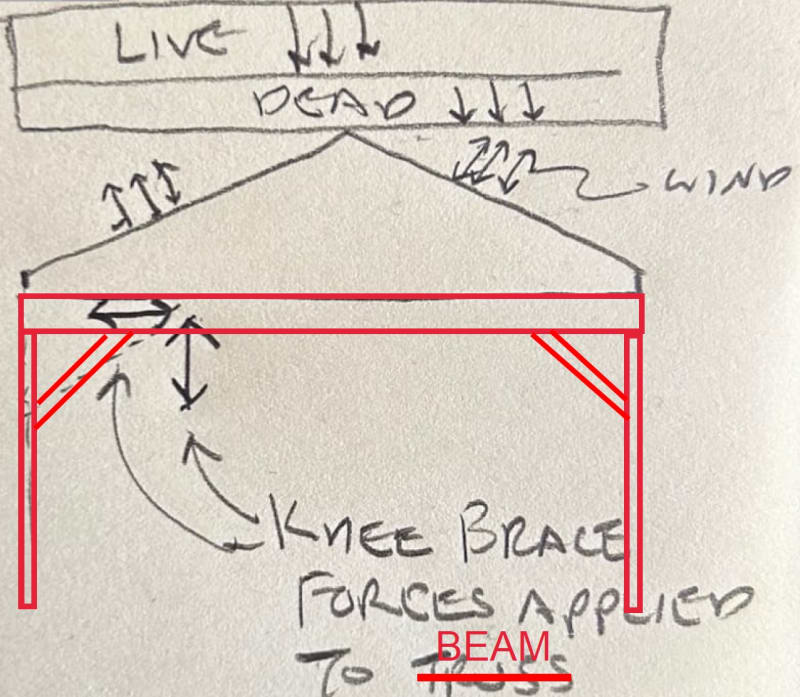

This framing is more common in these environs. It avoids transferring the loads through the beam to the end truss and having two different types of trusses. The trusses in the 'gable' area will be heavier to accommodate the cumulative lateral loads.

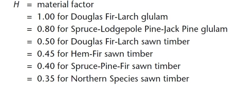

Dik - you mentioned timber rivets in a previous reply, are these applicable to sawn lumber or only glue laminated wood products?? Chapter 14 of the NDS wood seem to indicate only for glulam....
...for lumber Species as shown from the Canadian wood code CSA O86:
Curious if anyone else has used the approach as dik noted above. Using the Canadian reduction factors for timber rivets in sawn lumber for structures in the U.S.
