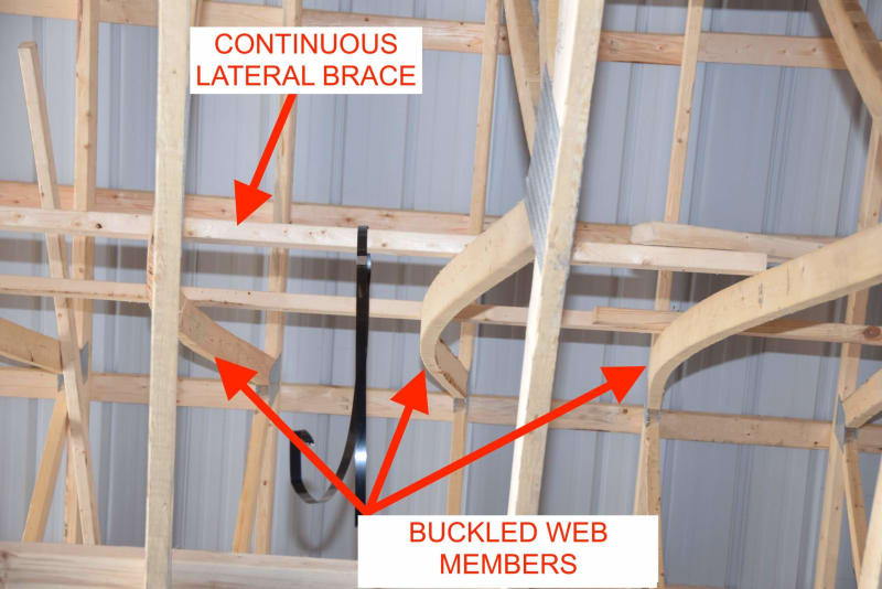

Here's a picture of a building I was in several years back. The diagonal webs needed 2 CLBs. where the webs buckled so far that some of them broke, and some pulled out of the plates at the ends of the webs.
I've seen buildings go down as a result of CLBs being installed wrong. Two winters back one of our customers had a large livestock building go down. The trusses had webs that required 2 CLBs. They put all of the CLBs on the webs, and even put them in the correct location on the webs.
But they did not brace the runs of bracing off to anything. So when the webs started buckling, the rows of bracing made sure that all of the similar webs buckled together. That increased the bending moment in the BC to the point that a splice plate snapped.
Thankfully the building was unoccupied at the time and no one was hurt.

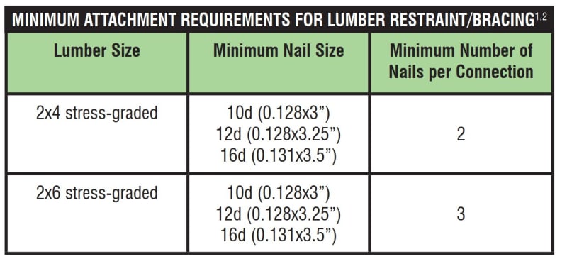

As far as designing the angled braces and the connections - Minimum nailing is called out near the top left of the BSCI document I linked to. Here's a screen cap:
