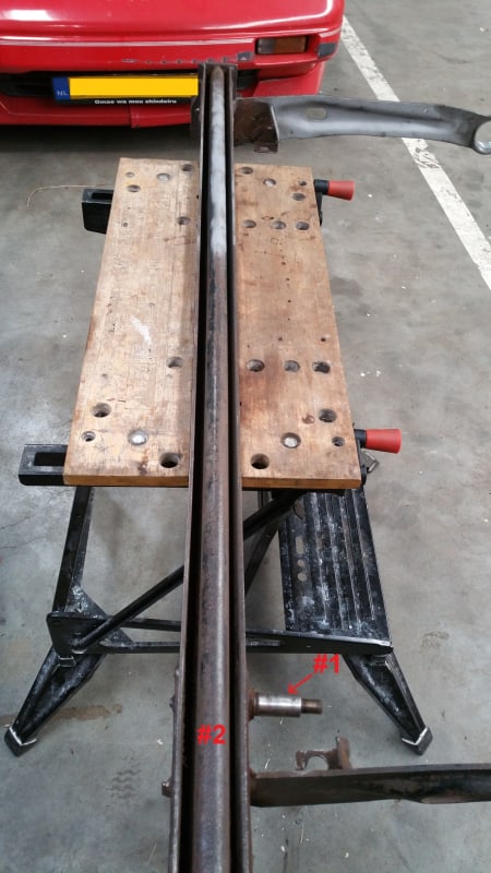

I need to determine if a unknown steel sample has received a heat treatment or not. So I'm advised by someone on another forum to have a laboratory perform an chemical composition analysis. I do think an Optical Emission Spectrometer (OES) analysis would be the most suitable because it is important to have the carbon content as well. Still it does not tell anything about the hardness and relating to that the tensile strength. So I assume I do need to add a hardness test also. Rockwell maybe.
What I'm wondering about is if the material composition and the hardness will tell me everything I need to know to purchase the right steel and possibly do a heat treatment on it.
Could it be for example that the part has gone a sloppy quenching process without tempering and still reach the same hardness as a part with proper quenching and tempering. So the mechanical properties of the parts would differ?
Once you know the material then you can decide if a simple hardness will work or if you really need tensile and micro.
For many steels there are three or four ways to reach similar hardness with very different properties (elongation, toughness ...).
While the UTS correlates with hardness fairly well for steels nothing else does.

With that last bit "nothing else does." You mean the other properties like elongation and toughness, do you?
Yes. You might have the UTS but yield, elong, toughness, and who knows what else may all be different.

What should that cost me approximately? I'm an automotive hobbyist from Europe. Sample #1 is round rod with diameter of 18mm and length of 30mm. Sample #2 is round tube OD 25.4mm and wall thickness of 2.7mm and length of 73mm. I don't care about coating I will grind that off before I ship the samples.

It is for a critical car part. I don't want to risk making assumptions about the steel. I do believe EdStainless is right in his advice to me.

Hi Zeyneb, Since you say the material is unknown you should make sure the chemistry testing will tell you elements to confirm if you have an alloy or carbon steel. The commercial testing lab I worked at had a standard suite of elements being tested for in steel that included C, Mn, P, S, Cr, Mo, Si, and Si. Phosphorus and Sulfur are reported to 3 digits, everything else to 2 digits. I prefer and request 3 digit reporting for carbon if it measures below 0.08% (this can affect welding parameters). The lab may use a carbon/sulfur analyzer for those elements instead of OES depending on what they get. Costs for simple chemistries like this are considerably less than what is discussed above but you local lab will be able to quote you a standard price before you proceed.

For #1, the panhard mounting point, I'm tempted to bet on 4130 as a replacement to save cost. I've asked them if they can check if sample #1 has received a heat treatment and if so, which one.
