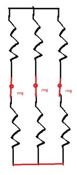

Hello. We have a Chinese-made motor with a wound rotor YZRDW250M-8/4 30 kW under repair. The rotor was rewound, the stator has a factory winding. Please help connect the rotor winding. As I understand it, the rotor winding is 8 poles, when operating at 750 rpm, the rings close, and when operating at 1500 rpm, the rings open. At 750 rpm (with closed rings), it works fine for us, but at 1500 rpm (with open rings), there is no rotation, the rotor can be turned by hand at the rated voltage on the stator. Thank you very much in advance for your answers

Hello. Thanks for your quick reply. I am sending you the winding data. The number of turns is 11, the pitch of the slots is 1-6, the diameter of the conductor is 1.4x4 (approximately 6.1 square millimeters). The length of the rotor active steel is 350 mm, the diameter is 280. This data was taken from the factory winding, the connection diagram is lost...

all that is known about the factory rotor circuit is a single-layer winding, pitch 1-6, 48 slots, 2 stars constantly on.
in the attachment it would seem that the circuit is correct, but it only works when the rings are closed (8 poles), when opened, the shaft rotates by hand at the rated voltage on the stator

I'm surprised that after performing a new rotor winding, you are unable to describe its configuration.
Please draw a diagram illustrating how you performed the winding, because as you reported, the motor operates at one speed but not at the other.

A WRIM is never meant to operate with an open rotor circuit.
"only works when the rings are closed (8 poles), when opened" there is no rotor current, no rotor magnetic field and no torque.
This will work only if there is a second slipring unit at the bottom instead of a short.
Consider a squirrel cage.
The rotor pole count does not have to match the stator pole count.
Changing the resistance in the rotor circuit changes the speed:torque characteristics of the motor.
Open slip rings represents infinite resistance in the rotor circuit and the torque goes off scale, on the zero end of the scale.
Your motor is doing what it is expected to do.
Yeah, these kinds of motors have been around for ages: 8-pole with rotor resistors, and 4-pole with open slip rings.
Quote: only works when the rings are closed (8 poles), when opened" there is no rotor current, no rotor magnetic field and no torque
But the thing is, what if the rotor winding's a closed loop, like a 2-wye setup like we've got here?
I'm guessing that's the case, since the OP still hasn't shared a wiring diagram of how they actually wound the rotor.
But you can't just slap any closed loop on the rotor and expect it to work as a 4-pole motor. To figure out the rotor wiring, you also need to know the stator winding configuration, which we also haven't seen.
Bottom line, these motors are a real pain, and it's super easy to mess up the diagrams, both for the stator and the rotor.
