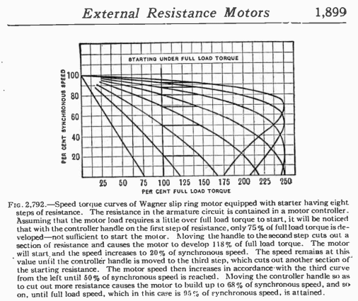

Does the added resistance in these motors on start up improve power factor. And also how is the inrush current limited I know that the as the rotors EMF passes the motor windings a counter EMF is produced decreasing the line current but how is inrush current different in these compared to squirrel cage motors?
Power factor will be better, on start up, but motors spend so little time spinning up it will not matter.
This fig does shows steady state torque. Inrush depends on the resistance inserted. Inrush will be approximately proportional to percent full loss torque at zero speed.

jK1996: In the big scheme of things developed torque (at any speed point) is dependent on the applied voltage, the current flowing in the winding, the power factor at that particular speed point, the resistance of the winding(s) involved, and how far away from synchronism the specific speed point is (i.e, the slip).

As any added resistance (e.g. a liquid rheostat or a switched resistor bank) in the rotor circuit becomes part of the rotor circuit during the start, it can be seen that the addition of resistance will have an effect on both the starting torque and the lock rotor current. More resistance in the circuit reduces inrush current (because there's only so much voltage to go around) and consequently the torque developed will also be less than a full-voltage condition.
Converting energy to motion for more than half a century
Gr8blu - are you trying to equate a wound rotor to a squirrel cage by saying what happens with a reduced applied voltage because your statement "the torque developed will also be less than a full-voltage condition" isn't making sense.
Torque doesn't go down, the breakdown peak just shifts around.
