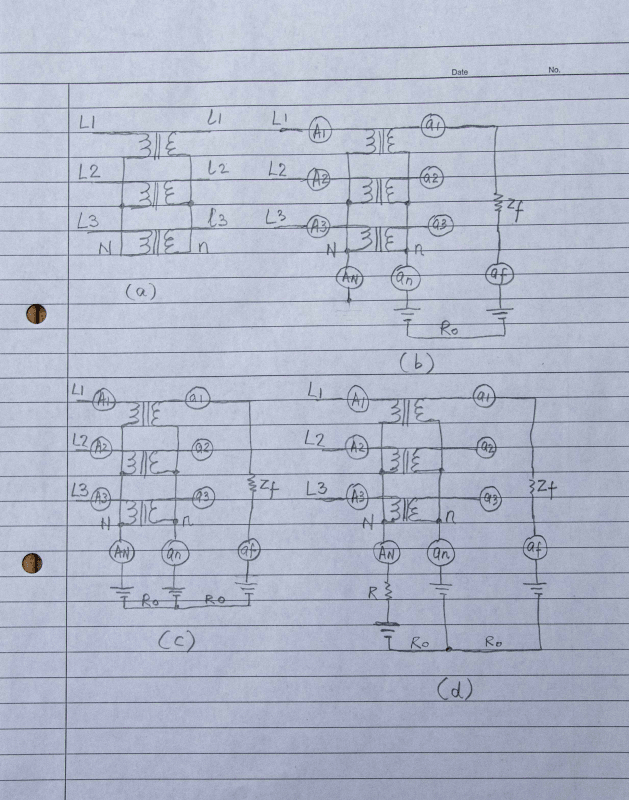

Dear Mr bspace123
B. "... I ... confused about the grounding concepts for wye-wye transformers.
1. Say ...,,. the primary side neutral is not connected to ground but the secondary side neutral is connected to ground, if we have a phase-ground fault on the secondary, will fault current flow from phase -> ground -> neutral of the secondary transformer? And will this fault current be seen as phase current on the primary side?
2. Say ... connect the primary side neutral to ground, will this change anything?
3. Is it common practice to bond the STAR points together if they are connected to ground for this type of transformer? If so, why?
4. If ..... both the primary and secondary side neutrals connected to ground, but the primary side is via a neutral earthed resistor, if we have a ground fault on the primary side, will fault current still be limited by the resistor? or will the bonding mentioned in point 3 compromise this?..."
C. I tried to sketch it out by using 3 pcs of 1:1 YNyn 0 Group connection with primary connected to a 3-phase 120deg source L1, L2, L3 without N. See attached drawing (a). To see whether it make sense.
C1. See attached drawing (b)
a) There will be secondary current a1=af=an ; but a2=a3=0 ,
b) There will be primary current A1, A2 and A3; with A1>A2 also A1>A3; but A2=A3 ,
c) The primary AN = 0.
C2. See attached drawing (c)
Current distribution is as C1 above.
C3. Is it common practice to bond the STAR points together ....see (c). Reason being to maintain the same earth potential.
C4.1. " both the primary and secondary side neutrals connected to ground, but the primary side is via a neutral earthed resistor, "
The statement is incorrect.
See attached drawing (d) where the primary N is earthed through an earthing resistor R. The secondary n is directly earthed.
Che Kuan Yau (Singapore)

This is a simplified explanation.
I will neglect magnetizing currents and quadrature effects to illustrate the effect of saturation on transformers in series with afloating neutral.
I will assume saturation occurs at a point rather than a knee.
Assumption.
120 Volt transformers in series across 240 Volts.
Transformers saturate at 120% (144 Volts)
Transformer rated current: 10 Amps
Load on the healthy transformer, T1: 1 Amp.
Available Short Circuit Current: 2000 Amps.
As the load on T2 increases, the effective impedance drops and the voltage across T2 increases.
Approaching saturation, the voltage across T1 will be approach 144 Volts. (120% of 120 Volts.)
The voltage across T2 will be 96 Volts. (240V - 96V)
The current will approach 14.4 Amps.
Once T1 is saturated, the impedance will decrease as the current increases.
With a short circuit on T2, the current will be limited by a voltage approaching 96 Volts. ASCC = (2000 Amps / 120%) = 1670 Amps.
The calculations are a little more difficult for three phase circuit.
The voltage will approach 1.73 times rather than 2 times normal voltage, the phase displacement between the healthy Phases will decrease from 120 degrees and approach 60 degrees.
However, for both single phase and three phase, the voltage across the healthy transformers will increase to the point of saturation, and once saturated the current will rise with the current demanded by the faulted phase.
The three phase fault current will be less than with a solidly connected neutral but will be significant.
I have ignored the effect of the X/R ratio and have ignored the error resulting from this oversight.
My intention is to demonstrated the effect of transformer saturation, not to accurately calculate the actual fault current.

Dear Mr waross
1. Thank you for your kind advice the procedure on when quoting a passage.
2. Looking forward to your learned advice on the current distribution per the sketch make sense at all. Thank you.
