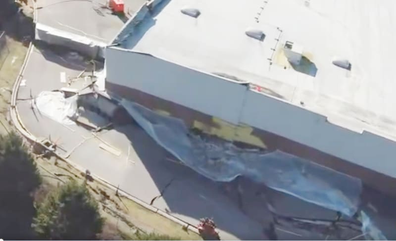

Yikes-Target Damaged due to Hillside Collapse 1
If your house was downslope of this, what would you do?

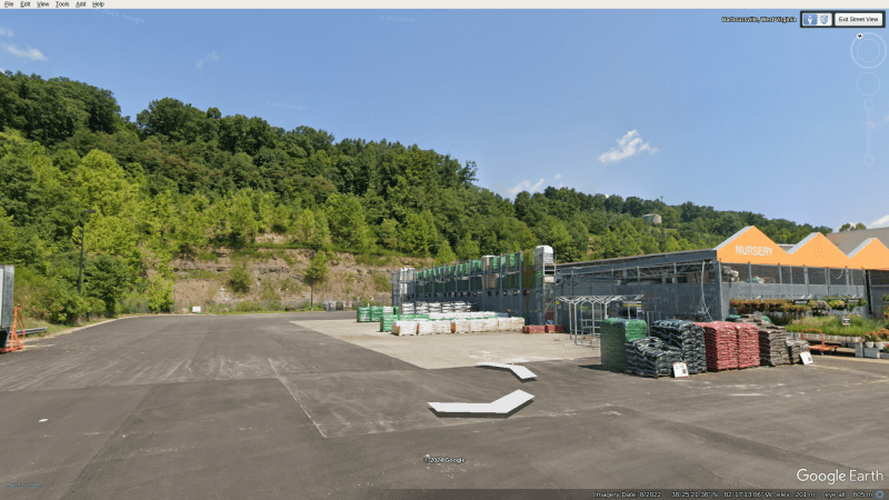

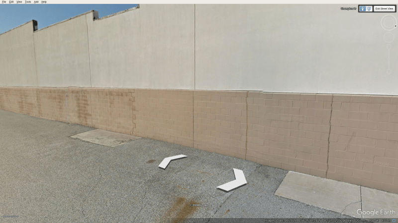

As usual, plenty of signs for those who know how to read them, at least from 2015 forward. I confess the advantage of hindsight. Interventions were underway but too little and too late.
Google Maps

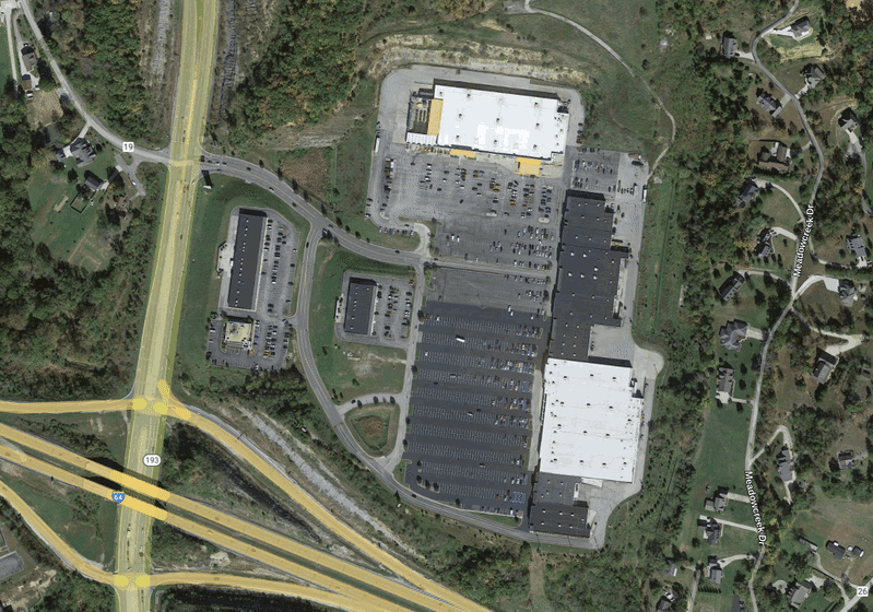

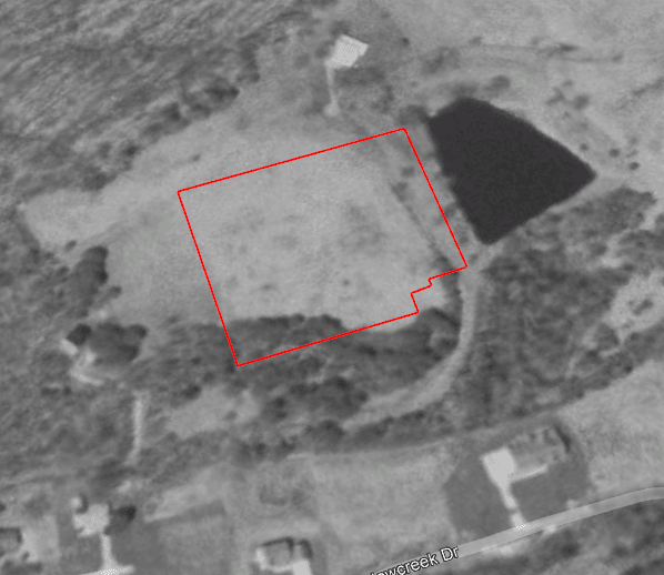

At the other end of the property, we see where the fill material was sourced to level the property.
Google Maps - overview
It looks like they scalped off the top of a hill and filled the edges to make the flat site pad. I read it was some leaking pipes that caused the recent failure, but I would imagine it was settlement or partial slope failure that led to the leaking pipes that then exacerbated the slope failure and the chain reaction kept making both failures worse progressively. I wonder if we'll ever hear the root cause analysis or if it will be buried in court files by lawyers and settled behind the scenes. I would not want to be the geotech, site civil, or contractor on this one. I imagine the store is going to be a total loss.

The target failure is interesting since the failure plane is pretty far back.
Given what we've seen so far, one can only wonder, "What else?"
