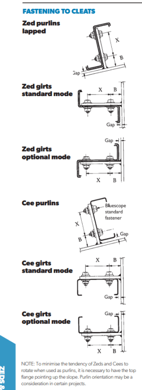

Just round out from photos that the roof Zee purlins in a 30 Y.O. building were installed with the top flanges pointing down hill. Remembering from 50 years ago Structures class that loads should pass through the shear center to prevent torsion buckling. With Zee section on 2:12 pitched roof, it appears pretty important that the top flanges point uphill.

You are correct, but the torsional issue can be solved with adequate bracing. What bracing/bridging exists?

If there are stiff mounting clips, that could be providing some roll-over resistance. You could just analyze the section and see what the capacity is when you include the torsion induced be the gravity loads.

Realizing that the OP is in the US, you are doubtless correct. But in some countries, e.g. Australia, purlin bridging has been the norm for longer that that. But then, correct orientation has also been the norm.

I'll try. For one, Australia has never had much in the way of 'pre-engineered' buildings. But it has historically used sloped roofs, not flat roofs. The metal roofing systems were developed with both the roofing and purlins in mind, and one reason for the bridging is to provide stability of the purlins for installation of the roofing. Think of the workers. The roofing and purlins have been typically provided by the same suppliers, and the 'design' has been just by using the manufacturers' tables, for both the roofing and purlins. These tables were developed by a combination of calculation and full scale testing, and have survived the test of time. For anyone interested, search for Lysaght and Stramit purlins and girts.
