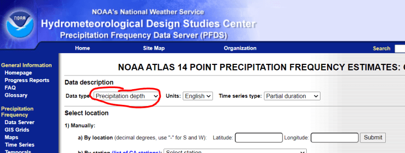

no, that is incorrect. you cant use peak discharge to calculate volume. you need to use the rainfall depth, not the intensity
Sorry for my ignorance.
I've got a peak flow rate, and I've got an intensity. How can I arrive at my rainfall depth? Is it simply the intensity * 24hr?
And then from there, how would I get my required retention volume?
no, you need the total precipitation during the 24-hour storm to calculate the runoff volume. it has nothing to do with intensity
Ok. Just determined that the 25yr 24hr rainfall depth for my location is 10.5 inches.
Now I would take the area (acreage) that is flowing to my rentention area, and calculate my volume?
precip depth x area x rational coefficient
