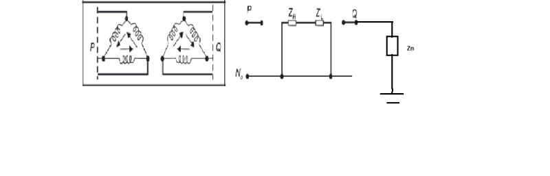

If a delta generator/network (without neutral) experience a solid line to earth fault. What will the fault current be? How can it be calculated/simulated?

Hi Guys, thank you for your valuable input. Assuming negligible capacitance. If the delta network experience a solid low resistance (Zn) fault to ground. Do you recon the fault current from line to ground to be Vfault/Zn? Based on the zero seq equivalent network for delta we see that the zero seq Zo is trapped in the delta winding thus I wonder what the fault current on the line would be. Would it be negligible too when the ground do not provide any path for the "fault current" to flow? Some kind off discharge?

If you say negligible capacitance, the fault current will be nil as there is no closed loop for earth fault currents to circulate.
The zero sequence impedance thus have to be theoretically infinity. It is windings to tank and cable capacitance that could allow some current to circulate, that's it.
What you have shown is a phase-phase fault because you have two connections to ground on different phases, which becomes a connection between phases.
Of course, but through grounding resistance.

What you illustrated is corner grounded delta.
