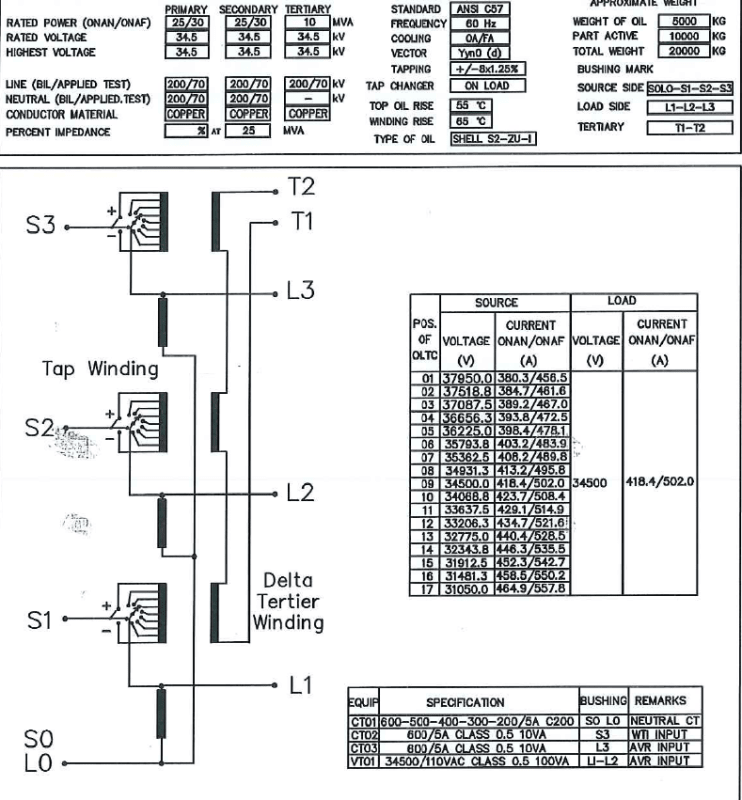

How to determine the zero sequence impedance of an autotransformer with a tertiary winding?
The following are the specifications I received from the manufacturer, the positive sequence impedance is stated as 0.2%, but there is no data for zero sequence impedance, is there a rule of thumb to calculate it?
Note: Currently, its tertiary is delta connected, and the neutral point is connected to ground
Regards,
Absent any zero sequence test data, and assuming a single 3-phase unit (probably a safe assumption at that size), I'd go with R0 = R1 and X0 = 0.85 * X1. Seems to work.

Does the construction of an autotransformer winding affect its zero sequence impedance?

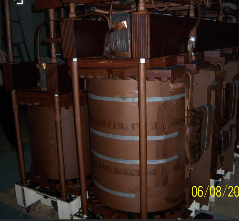

The transformer above consists of 2 different cores, here is the drawing and photo below

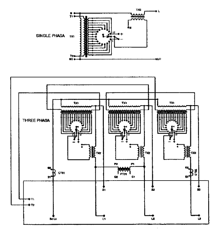

Meanwhile, we have another autotransformer with a drawing like this, unfortunately, there is no photo, but it seems that there is only 1 core in this autotransformer.
This is a special transformer -an autotransformer with a series booster transformer on the secondary. So, the impedance will be the sum of these two transformers. Better contact the manufacturer. You can roughly estimate the zero sequence from Table 1 of IEC 60076-8 -Transformer Application Guide for regular transformers with different connections.
Thanks prc, IEC 60076-8 is such a good read.
Based on that table, I think X0 = 0.85 * X1 is a good estimation
