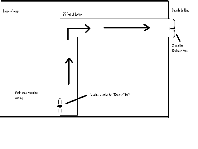

It was suggested by a coluege that I visit this forum for some help. I need advise regarding the sizing for some exhaust ductwork in my fab shop.
I need to vent a work area, and need to use two 16 inch exhaust fans that I have in the shop already. They are mounted side by side. It will require 25 feet of ducting to get to the work area.
In the HVAC field, is there a calculation that someone can explain to me to properly size this duct to minimize the loss in airflow from having too small of a duct size?
The fans are grainger #3xk40

Is there any way that I could mount a suitably sized "booster fan" at/near the duct entrance to make this acceptable?
See proposed picture at:
Again, thanks for the help... I like to be aware of the concepts to this project before I call a professional in the area,
ryan
This fan isn't going to work ducted, Ryan. You need a different fan. You'll likely also need separate systems for localised exhaust and general exhaust and ventilation.
I don't recommend installing two fans in series. It is best remove the existing fan and install a inline centrifugal fan with some ductwork.
I'm assuming you are only using this to remove heat. If you are using this in a garage setting where a high level of combustable fumes are be exhausted, you might want to have an explosion proof fan motor. This is a spark resistant motor that won't ignite fumes in the exhaust airsyteam.
You might want to consider hiring an consultant engineer. They are sometimes listed in the yellowpages. This might be an overkill but I not sure what are you are doing.
