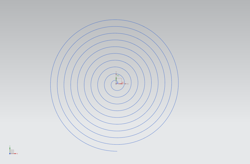

And here - correct involute curve, 10 turns.
Be happy!

Look in your NX installation, in the folder \Program Files\Siemens\NX 10.0\UGOPEN\SNAP\Examples\More Examples\Gear. There you will find a VB program that creates involute gears. It uses SNAP functions, but, if you don't have SNAP, it should be easy to adapt to use NX/Opejn functions, instead.
Part of that program is a function that calculates a point on an involute curve, as follows:
Code:
   ' Calculates positions on a segment of an involute curve
   Private Shared Function InvoluteFunction(data As Object, u As Double) As Position
      ' Note that the involute curve here is parameterised by radial distance from the origin (r).
      ' The more common approach is to parameterise by angle (theta) but this causes a
      ' singularity at the start point (derivative vector has zero length), which leads
      ' to a nasty Bezier curve whose first and second poles coincide.
      Dim params  As Double() = CType(data, Double())
      Dim a   = params(0)         ' Radius of base circle of involute
      Dim r0  = params(1)         ' Radial parameter value at start point of involute segment
      Dim r1  = params(2)         ' Radial parameter value at end   point of involute segment
      Dim r = r0 + u * (r1 - r0)
      Dim theta As Double = System.Math.Sqrt(r*r - a*a)/a
      Dim x As Double = a * ( System.Math.Cos(theta) + theta * System.Math.Sin(theta) )
      Dim y As Double = a * ( System.Math.Sin(theta) - theta * System.Math.Cos(theta) )
      return new Position(x, y, 0)
   End Function
Note the comment about the singularity at the start of the curve. It's possible that this is causing a problem in the Law Curve function.
In some cases, the involute curve is extended with a straight line. This might be related to the "undercut" idea mentioned in cowski's answer
