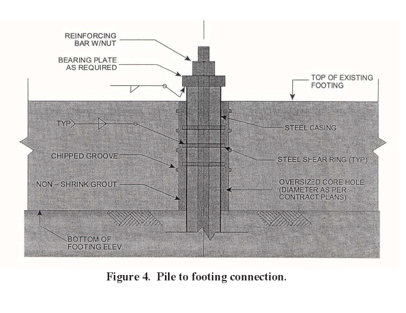

This has similarities to micropiles (albeit that your pile diamter is not so 'micro' at 13-3/8" diameter).
Some details that I have seen of the micro pile top-to-footing connection are as follows:
Agreed. This system is poplar in my domain: Link. When casing is used it is usually just there to a) prevent the grout hole from collapsing and b) provide some nominal lateral capacity.
bookowski,
This download Link by Dr. Donald BRUCE, et al, on micropile design maybe useful.
@Ingenuity: star for you; mystery solved.
@Bookowski: it appears that, in the absence of some kind of casing cap assembly, the plug capacity based on equation five of Ingenuity's attachment would require attention. I'm curious to see where you land with this.

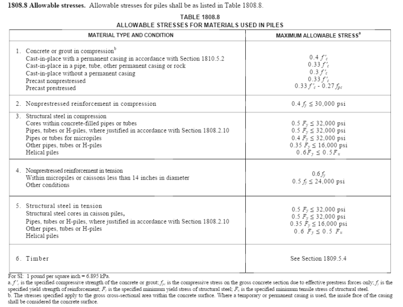

I don't think that equation would be satisfied just based on eyeballing. My full capacity is 0.33f'c so I'm only gaining 7% there, I have 0.5Fy for the bar so I'm losing 3% there, and I'm losing the full casing strength. My capacity is given by the '08 NYC building code which is free online, the '14 code has similar equations as well with slightly different factors. From '08: 1810.7.5 Allowable stresses.The allowable design compressive stresses shall not exceed the following: concrete, 0.33f'c; steelpipe, 0.35Fyand structural steel core, 0.50Fy.
Seems like it just doesn't make sense in terms of load path but isn't causing any problems. I will update this if I figure out that it does make sense and I'm missing something.
I checked out the NY code clauses. They say that the allowable stresses should be as indicated below for the individual components. However, they do not directly specify the assembly combinations to be used for design. Presumably...
0.40 x f'c x A_grout + 0.5 x Fy x A_Center_Bar
...would be as applicable to the uncased length as...
0.33 x f'c x A_grout + 0.5 x Fy x A_Center_Bar + 0.5 x Fy x A_casing.
...would be to the cased length.
