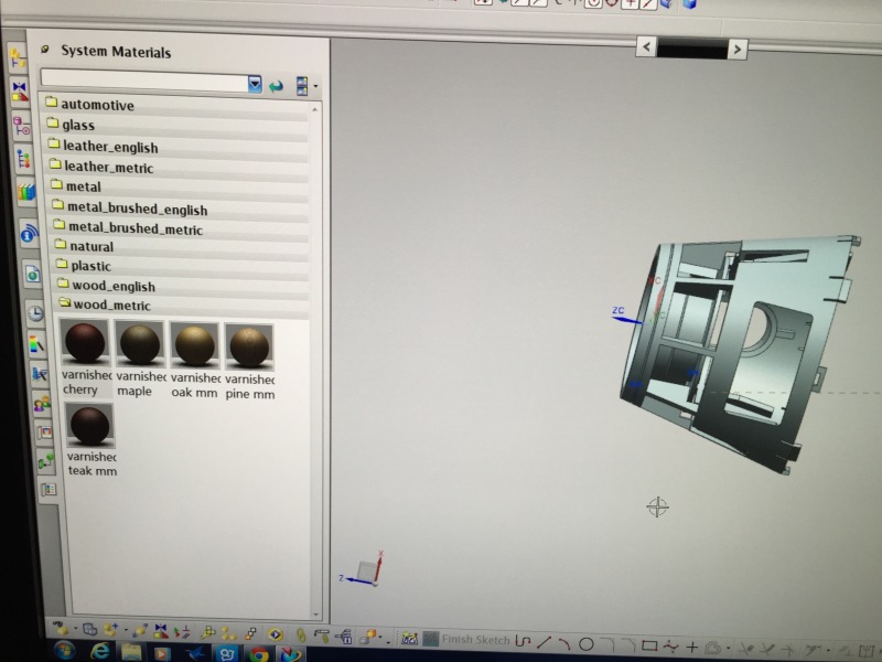

I was trying to apply different colors to components in an assembly by drag and drop different materials/colors, but it doesn't work. It worked just fine before, is there anything I turned off/on accidentally?

I attached a picture of the mode that i'm currently in, is this what you were talking about?

Press MB3 over the graphics area and under 'Rendering Style', select 'Studio'.
