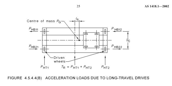

I was referring to acceleration loads PHB due to long-travel drives as shown below.

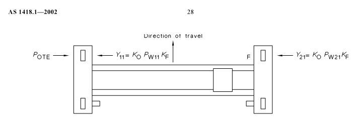

and oblique travelling loads (Y21) as shown below

PHB forces act when the crane accelerates / decelerates along the runway with the ladden hoist located elswhere than in the centre of mass. They (the forces) are not due to transvere acceleratio/deceleration of hoist.
Y forces are born when the crane travels along the runway in a skewed position and the wheel guides make contact/hit the rail. This contact "straighten" the crane along the runway.
These forces are associated with long travel only, that is crane/hoist travel in one direction at the time.
