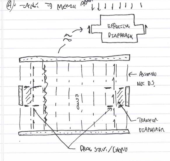

My thoughts:
1) It's either full depth diaphragm at the shear wall with a drag strut or it's a partial depth diaphragm just like you've proposed the numbers.
2) You can do a partial depth connection to the walls but it requires a) a high demand transfer diaphragm and b) some EW chord members as shown in the sketch below. If your EOR doesn't have these things, then he or she doesn't have a partial depth diaphragm no matter what their preference. In theory, with the deck oriented in the right direction, you could eliminate the EW struts and use the deck in in-plane bending instead. That involves a lot of deck detailing that likely isn't present however. And, in general, I simply dislike the concept.
Time to embark upon some EOR educating it seems. And yeah, if it's a 25' angle, it's a 25' angle sitting on top of a real framing member.
