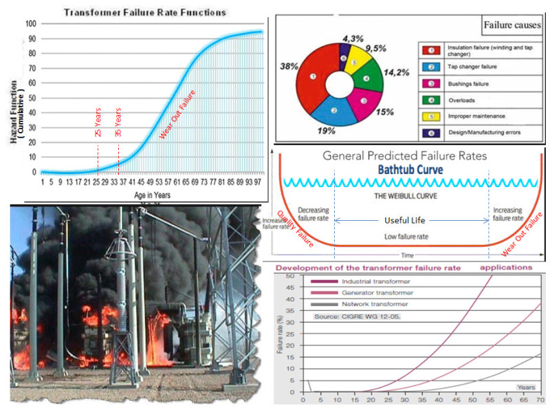

IEC 354 thermal model for transformer hottest-spot calculations is very similar to the IEEE Std. C57.91-1995 classical model. Should be noted that
transformer failure could be best characterized as a stochastic (probabilistic) model rather than a deterministic approach. For illustration, below are a few graphics and picture from various source showing basic probabilistic tools to consider in failures analysis in power transformer. Hope this help with the discussion.
It is worth to point out that several utilities, which adopt the N-1 security criterion, rarely have an average load higher than 50% on their transformers. When the average load is low, thermal ageing is almost negligible and mechanical wear due to short circuit stresses is the most significant fault cause: this is tipically the case of EHV/HV transformers and autotransformers.
