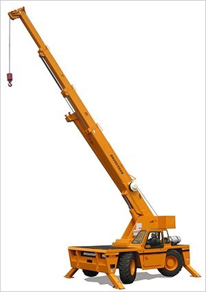

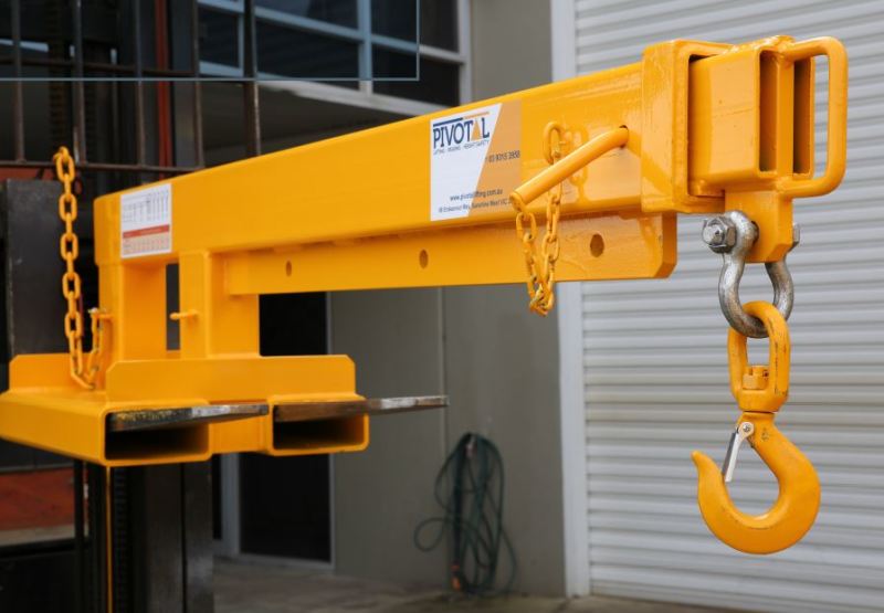

Seems to me that the best way to do the work is with a carry-deck crane that is rated for a pick-and-carry operation with the load slung under the hook and snugged up close to the front of the crane. Something like a Broderson IC-200 or so. Maybe could make/buy a lifting jib to allow the load to be slung under an elevated forklift mast.
