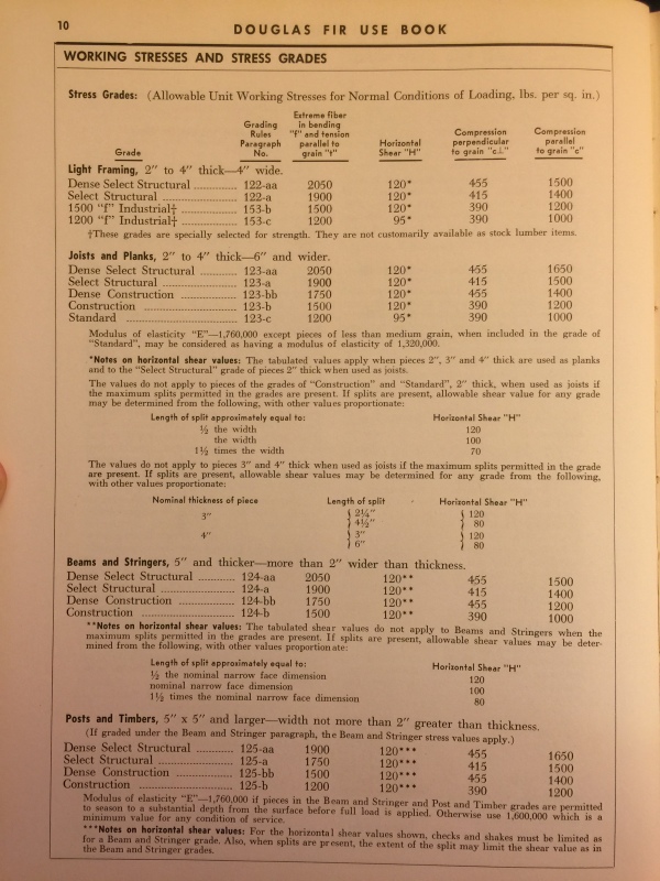

From the 1967 UBC table No 25-A (page 165), for Douglas Fir, Coast region species, what is the equivalent grade for a No 2 DF joist? Have the grade designations changed since 1967? Here are the ones currently in the document for the species I mentioned:
Select Structural
1750f
1500f
1200f
No mention of the regular No. 1, No.2 etc. grades... Any ideas?
Yes, the grading agencies modify the allowable stresses frequently (every code cycle if it's southern pine). It wouldn't surprise me if the grades have also changed over time. You will probably need to locate what the allowable stresses are for each of the different grades and compare them to modern grades. I imagine its probably pretty analagous to Select Structural, #1, #2, and Stud.

I'm specifically looking for bending and shear stress capacities for a 1973 project, for DF No 2. The UBC archives are not freely available and quite costly (up to $200 a copy). Any way I can get these values? I feel like this stuff should be public information...
awa5114...keep in mind that the ICC is a profit seeking organization. I agree it should be public information; however, even in my state where the building code is a statutory document, we still have to buy it!
Awa5114:
Take a look at the NDS (National Design Spec. for Wood Construction, or NDS for Stress-Graded Lumber and Its Fasteners) and its various Supplements (various supplement years) for the specific wood grades and design stresses. That’s what would most likely have been followed for the design of a wood structure at that time. Not only do you have to pay attention to the species, but also to the grade name and then the specific grading agency in some cases. See if you can find some grading stamps on the members, for starters. Then, what NDS and its supplements was being used at that time, in your area? The UBC essentially copied the NDS, literally word for word, at that time. In fact, copies of the UBC from that time contained the complete AISC, ACI and NDS codes, and others, within its covers and it could be carried in one hand. 5.5"x8.25" high by 1.75" thick; it was reasonably affordable, usable and understandable too. Ah... for the good old days. The allowable stresses and the mech. properties have continued to decline in value, over the years, as we’ve learned some new things about wood, and as we are cutting younger and younger trees for lumber, wood quality has deteriorated.

My 1973 UBC shows 1250 psi and 1450 psi for single and rep uses for DF#2, 2" to 4" thick, 6" and wider.
Unfortunately, I do not have anything earlier.
Mike McCann, PE, SE (WA)
awa, try the below. This is from a 1958 DF Use Book.
Amazing! My copy shows the same thing! [smile]
