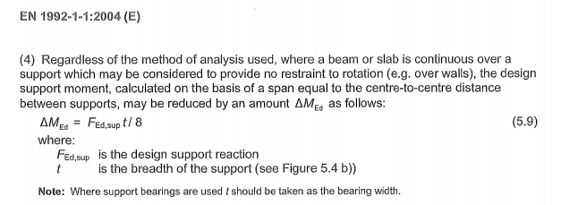

The design assuming continuity should be done using the full centre to centre of support span length. Checks on slab negative moment capacity should be made at the normal critical section and at the edge of the beam support.
The beams shown on this drawing are not stiff enough to justify anything else.

Critical sections for continuous slab negative moment are at the beam edges for slab with transverse beams and at edges of band & face of column for slab with bands beams. Can I say so? I can't recall what the code says :). I think Eurocodes allows us to reduce the support moment for the continuous slab and beam as follow.
