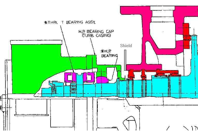

A 4400 rpm high temperature steam turbine vibrates intermittently. The fouling/coking of the oil labyrinth is suspected as origin. If this is the case and after confirmation, it is possible to clean the deflector with the turbine in normal operation by means of a special high-pressure cleaner (steam or water). Do you have such an experience, result? Could the rotor start vibrating? The small quantity of water entering the lube oil system should not be a problem (short time operation).
"The fouling/coking of the oil labyrinth is suspected as origin." I doubt this hypothesis is correct. Analyze and correct the vibrations first, and the oil coking from high temperature may go away.

I acknowledge "coking" of an oil deflector happens and causes vibration problems.
ensure proper air flow in the area is something I tried to ensure during outage to prevent. Usually needed to install a shield that would hold thermal insulation back.
a "far fetched" ideal....could you drill into the oil deflector cavity so that cleaning fluid could be injected that would dessolve the burnt oil. Then an air purge could be used to midigate the reoccurance.

byrdj: you're right, I will try to inject air (not easy but feasible) and protect the oil deflector with a shield.
this image is an unit I had experiance with where thermal isulation would block the oil deflector's air gap and I would as a SS plate to the end of the HP casing to defind the needed clearance
in my case the brg housing and oil deflector are hot due to steam leakage.

Normally the coked oil is found like a ring inside the deflector and so around the rotor but not with the same hardness/stiffness in all directions . The rotor displacement is limited in some directions and vibration may happen. I have seen deep groove in rotor due to accumulated particules inside oil deflector.

Getting water in the lube oil may not be a problem, but what about fugitive coke particles that get into oil? An air stream for cooling was mentioned as a short-term measure to minimize rubs. The GE paper mentions a long-term solution to minimize coking. Some of the papers discuss the difficulty of removing coking that is common to steam and gas turbines, compressors and turbochargers. A rub that causes phase change is sometimes referred to as Spiral Vibration when vibration vector amplitude and phase change. This may occur when a shaft critical speed (balance resonance) gets excited by the rub.
