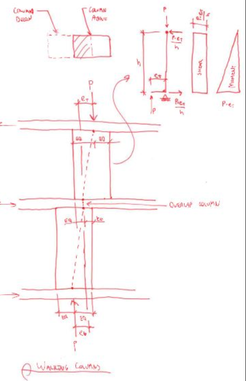

I've attached a sketch of the column in case that clarifies what I'm asking about.

I believe that we were discussing exactly your case (sketch below taken from that thread), in intricate detail. Pretty sure we hit upon most of your specific concerns as well. Specifically:

As broached in the other thread, many people deal with the eccentricity via slab moments. I disagree with that as I believe that the columns are the stiffer path for the moment that arises from eccentrically applied column axial loads. Consider:
1) Columns are often uncracked,
2) You've got the whole "moment leakage" thing going on at the joint just as with gamma and regular slab moments.
3) The stiffness of the joint to transfer moment from column to slab is pretty dubious in these situations.
I also feel that there is moment, and additional shear, in all of the walked columns, not just the lower one.

As mentioned in the other thread, I think that it's also prudent to give some consideration to strain in those drag struts, all the way back to the lateral resisting system. The more the strut stretches, the more punching shear you potentially add to your slabs. Good sketch of the concept in the other thread.
